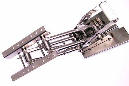

Thanks all, but I am looking for advice on a transom mounted motor mount.... Like Catalina direct or Marine tech1581265569701.png

I installed a CD three spring for my daughter’s then C25. She had a 9.9 Two stroke that weighed 75 lbs. The three spring was so strong that I had to disengage one of the springs. The three spring CD mount was very smooth and well constructed. I’m sure it would handle the 8 hp Honda easily.

Hi Mike, this is very helpful, thanks. Last question....my current transom mounted motor bracket is attached to a plastic "slanting box?" which tilts the mount away from the top of the transom for more setback for the motor tiller. It is about 4" thick / deep at the top, tapering to zero at the bottom, and 5 1/4" wide. The CD mount is 1 " wider so I may need a new one. Do you know if these are commercially available and if so, where? Thanks.

Hmmm. I would start with Catalina Direct or sailboatowners.com.

The mounting bracket from CD is manufactured by Garhauermarine.com . They sell them Directly to the public, although they are not listed on their website. You can call them for more information.

Sage Marine uses only the Garhauer Marine (Catalina Direct) mounts. Although Garelick, the original supplier of "2 stroke" mounts for O'day has since updated and made new mounts for 4 strokes, from what I've seen and discussed with the former production manager of Sage Marine, if I decided to replace my mount, I would only go for the Garhauer mount. It is very well built and smooth working. Because it is available with different spring configurations, it can hold the weight of almost any small outboard for a sailboat.
I'll also second the notion that you should go for the longest shaft motor you can get, which is usually a 25" shaft, often found on "Sail Pro" model motors. The other usual sizes are 15", and so called "long shaft" at 20", but for a sailboat where you want to keep the prop in the water and driving at all times in steep, rough seas, the 25" shaft is recommended.

Thank you! I went with a 25" Honda 8 HP4 stroke and a Catalina Direct 3 spring with backing rails.
