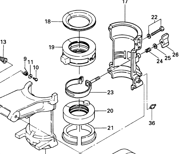

On my Tohatsu 6hp outboard: has a thumbscrew on the back to control friction on spinning the top. It says in the manual not to be used to lock the motor in place. It's not kidding, can't be done. Anyone been able to make it happen or are bungee cords or cables my only option?
Remove said thumb screw, go get longer bolt in stainless that is 1/4" longer. take drill bit smaller than bolt and with motor in correct position drill small divit inside hole for new bolt to seat in. Install new bolt with gob of grease to prevent corrosion, motor is now locked.
If the tensioner bolt pushes a shoe the drill may not be required or you may have to dril and tap thru it and then install the bolt.

Also, I saw somewhere where someone wiped most of the grease off of the shaft then glued sunbrella material to item 23 in the parts explosion to increase friction. I can't find the link for it but if you do enough searches you might fine it.

Without having this exploded view I thought that the bolt might be pulling on a clamp and added s s washers on the outside of the housing hoping T o increase the strength of the clamping. No luck with that, I will look at these other suggestions, thanks guys.
I remember reading the same thing. Sounded like just a way to get more clamping power to hold it tighter. Do I also remember correctly that by applying to much clamping force you can damage the shaft before you lock it in place. Sounds familiar to me.
On my 4hp Tohatsu I remember the same thing JSG posted. It was a clamp around a shaft that couldn't be defeated. Even my 9.9 Yamaha can be tightened down but not locked. That's OK with me as I use it to steer in tight places. Only minor inconvenience is when I tilt it back out of the water and it tilts to one side or another while sailing. I have to lower it before I can straighten it.
I do have it set tight enough it never moves from whatever position I set it when under power. That works well enough for me.
