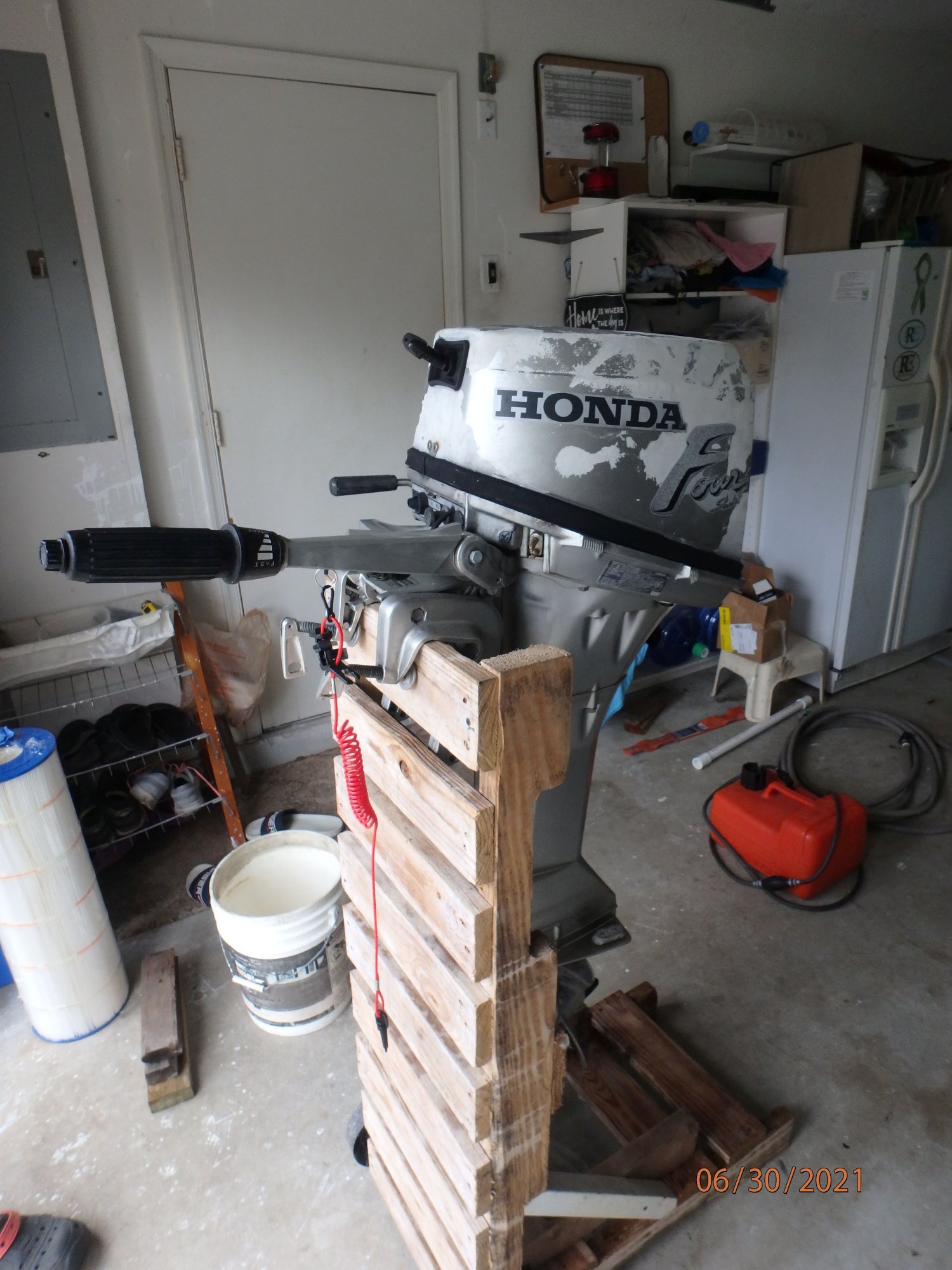

I have a twenty year old Honda BF8A outboard that is refusing to start. It seems like an electrical problem, maybe coil. To me outboards are like sports cars, they need mothers. Do I learn every nook and cranny in this thing like I did on my '63 Dodge Dart (new nylon distributor drive gear every 30,000 miles) are do I pop for a new 8 HP Honda and drop $3,000? I only use the motor for entering and exiting the Marina. It doesn't take much to push my little Hunter 240.Honda Outboard.jpg I could get by with a trolling motor. Brain storming is welcomed.

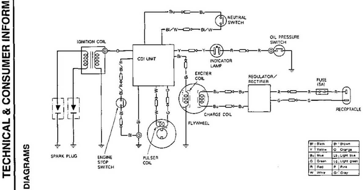

OK, this has now become a macho thing. I can't believe that I have been sucked into working on this engine. I have the wiring diagram and it shows the lanyard kill switch and the neutral position switch. I had already checked for spark so I am pretty sure it is not a fuel issue. There was no water in the fuel filter ( which i flushed). I had also changed the spark plug. I will go back up today and hang off the transom and see if I can ohm out the components.
Well, both the Kill Switch and the Neutral Switch have checked out. They had insulated snap terminals that made them easy to ohm them out. I also checked the circuit to ground. I drained the carburetor, re primed, and tried again. I had checked the spark plug yesterday (I did discover that I have two spark plugs). I hate to start just buying ignition parts but substitution is the only way I know to troubleshoot it any further. It usually is the last and most expensive component that fixes the issue. I also found the lever to unlock the outboard and swing the prop out of the water. Zoltan (previous owner) said that he only used non ethanol fuel. I am impressed with the entire Honda package, engine, fuel line, and fuel tank.

Use your ohmmeter to test the windings of the pulser and ignition coil. Pulser and ignition primary should be 1 to 100 ohms. Ignition secondary should be higher than that, maybe 1000 to 10000 ohms. Any coil is completely open and you have found the problem.

You probably already did this, but make sure the oil is full. The BF8A has some kind of oil level switch (shown in your diagram) and it won’t run if the oil is low. I guess the oil level switch could be bad too.
I found this out the hard way once, when I couldn’t get my Honda generator running. Turns out, the last time I changed the oil, I under filled it. I topped off the oil, and it started right up.
