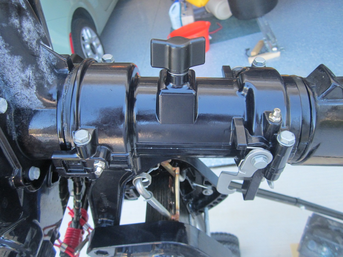

I have a 6-hp Tohatsu SailPro, and I'm kind of mixed on it. It's has better reliability than my old Honda 5-hp; but, it's been disappointing in other ways. I like the front mounted gearshift (F-N-R), but the controls for raising and lowering the motor are difficult to find and reach, and the motor doesn't track well - the knob that is supposed to hold the motor in place to go straight ahead simply doesn't work (Captain Don engineered a work-around, which will be a year-end project for me).

I can tell you the modification I came up to correct the ineffective steering friction lock issue on my new Tohatsu 6 HP Sail-Pro has been very successful I believe. After I installed the modification we motored for 4 hours from the ramp to the slip at our friends home, and the outboard remained in the position I had her pointed. Most recently we attended the C-22 Fall Cruise. We did a lot of motoring, probably 80% or more of the 118 miles we covered during the week cruise, and the engine remained in her adjusted position. We now have over 80 hours on the engine, and I believe the modification has been a success.
You can read all about it, with lot's of detailed photos in the Catalina-22 magazine, the MainBrace.
