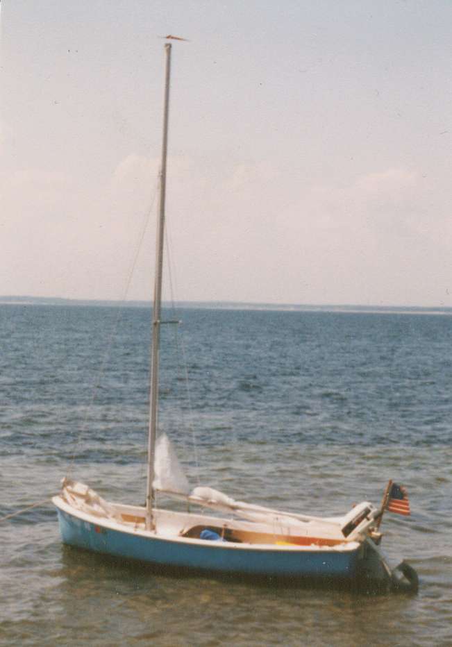

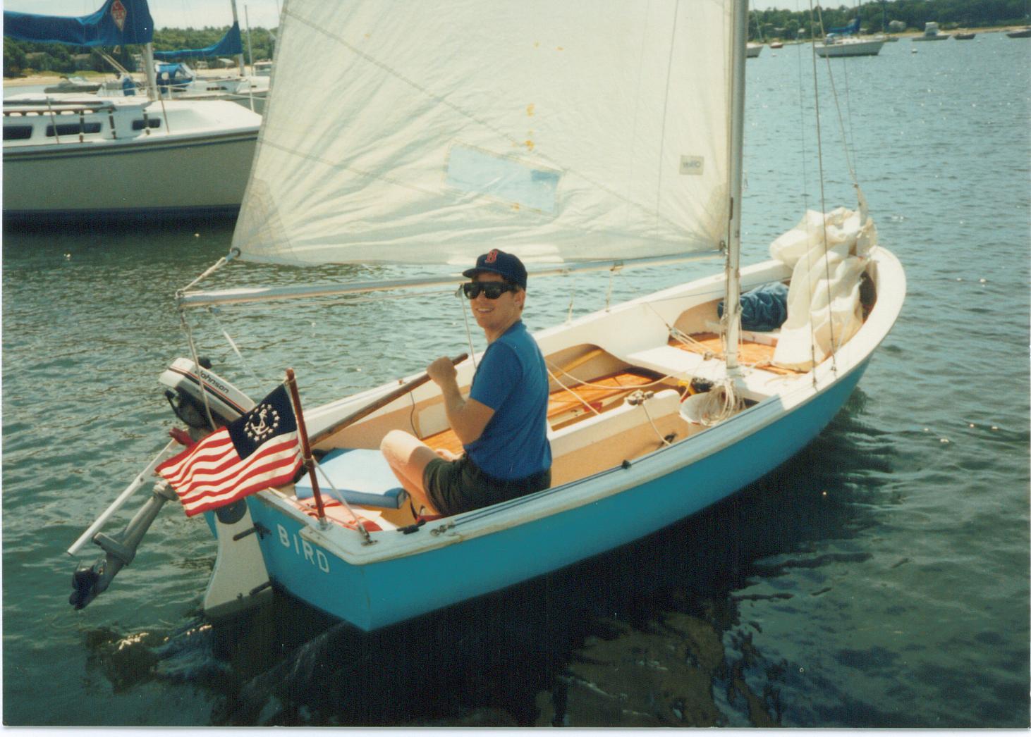

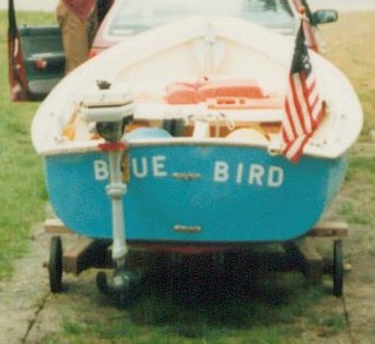

I used a 1984 2hp Johnson on my 1970 WIDGEON, I did have to watch the mainsheet when tacking, but it worked OK clamped onto the transom even while sailing. I offset the outboard to Port side, and it did not seem to create a problem with the rudder. I later used a 1992 2.3hp Johnson which was a little tighter fit, but still worked and since it had 2 clamp screws, I could lock it on if I left it on boat overnight (the 2hp only had one clamp-screw, so it fit a little better, but no good way to lock onto boat) With both motors I did need to be careful when turning to port, as the rudder could hit the outboard prop, but the plastic props couldn't really damage the aluminum rudder blade! The 2.3 did have an anti-ventilation plate above the prop and I added a plastic "fin" to that on the side towards the rudder that was sized to stick out just slightly more than the prop so that fin hit the rudder before the prop could.
