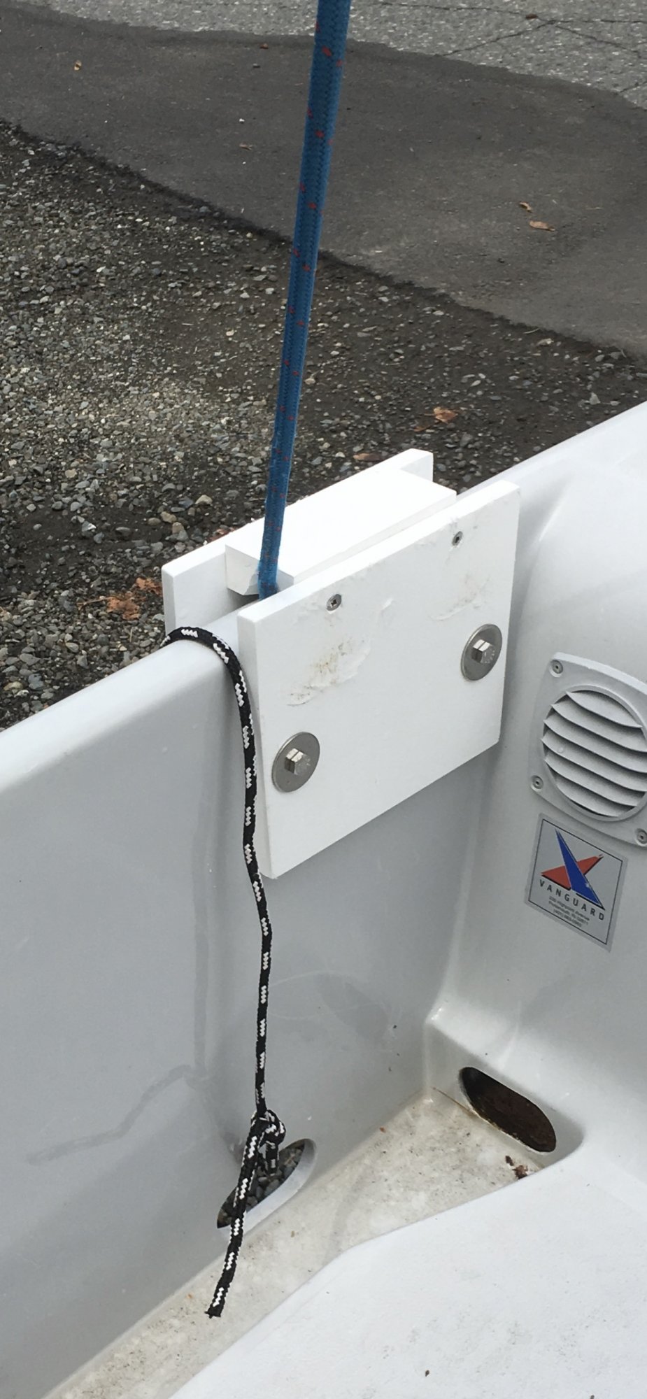

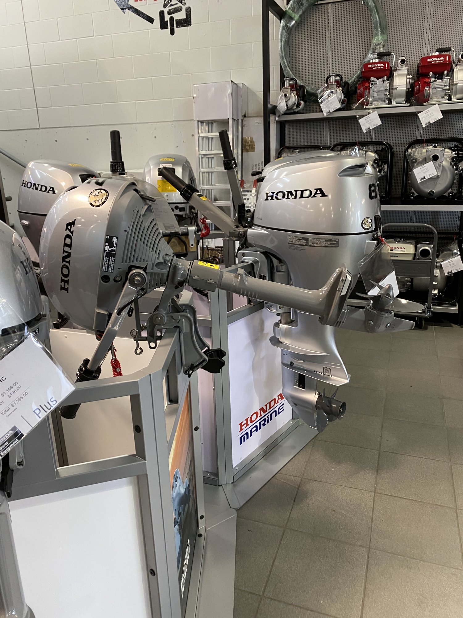

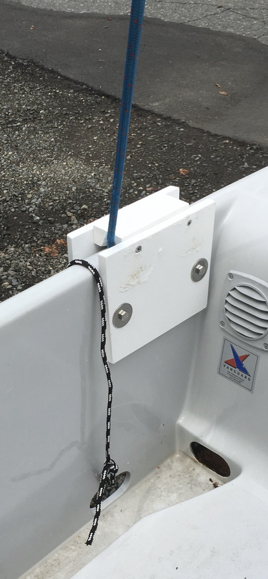

I am a purchaser of a nomad 17 sailboat. I would like to put a small outboard engine on. I’m thinking of a Honda 2.3 hp four stroke. I was wondering whether I will need a outboard bracket. I’m trying to keep the weight down. Wanna make sure that the engine could tilt up. I went to the dealer today and the long shaft which is 20 inches. It can tilt up completely but would like some advice in making a decision prior to purchase. Thank you .

The photo appears to show a mount that I don't see in some other photos of the boat. Is there something missing from that mount?

Thank you very much for your input. I will include better pics of the transom
