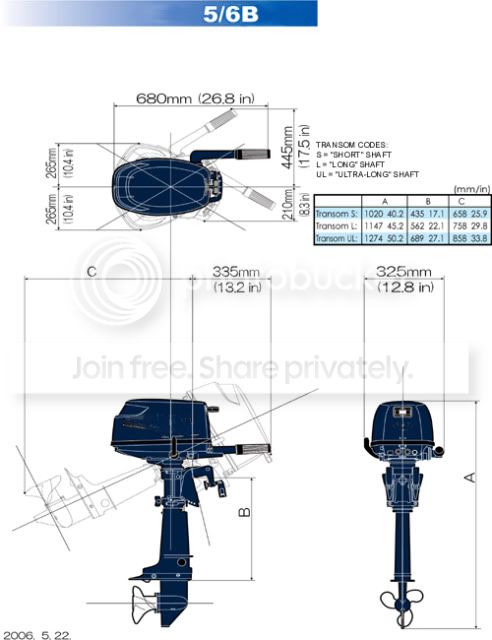

You need to measure and if it's 15 inches it's a shorts shaft and will never work well
10,253
Long shaft will keep the prop in the water much better.. There is a steering tension adjustment that you can tighten to get the engine to stay straight and still be able to turn it with the tiller for tight turning.. The adjustment usually would be located just above the clamps that hold it to the bracket, or possibly just below the clamps on the swivel tube..
Outboards usually can be converted to long shaft (if they were offered that way originally) There are some folks who can supply the parts for a lot less than a new engine.. Try to find a good local shop that works small outboards and talk to those guys..
