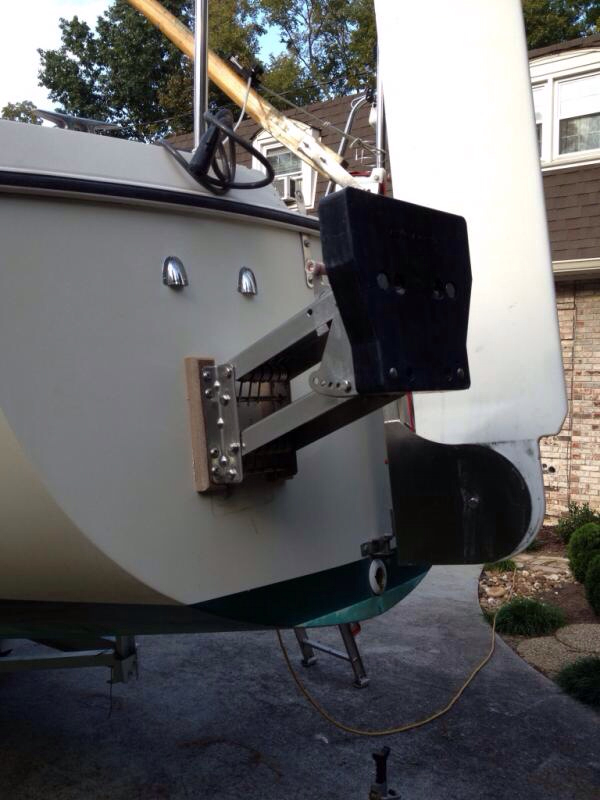

I want to replace the bracket for my 9.9 H.P. outboard.
Is there a bracket available that can be adjusted to compensate for the angle of the transom. I don't think the wedge will take the additional weight of a four stroke and I would like to eliminate it completely.

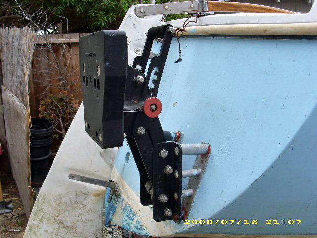

The PO did this for the Garelick bracket on my 22. I am running an 8 hp sailmaster 2 stroke.
Eight through bolts with aluminum spacers cut to the transom angle. Reinforced inside and out.

Garelick makes a couple of brackets with the angle adjustment built in. See their website for installation instructions, and precautions.

If I were getting a new 4 stroke outboard bracket, I don't think I'd go with Garelick again. I think I'd consider the stainless steel bracket from Garhauer. I've seen it on the Sage 17, and I trust Dave Scobie's decision to use it on the Sage. It's a nice looking bracket, with a far nicer lifting handle than the Garhauer.
