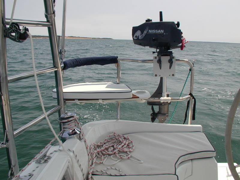

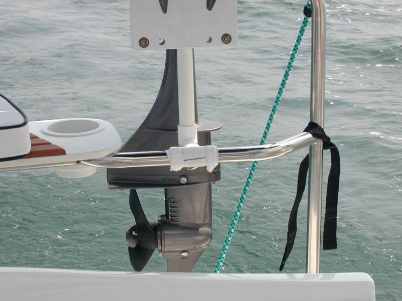

On an h320 a piece of 4" X 6" treated wood cut to width and held by 3 "U" bolts to the rail. Installed between the starboard stern rail seat and the walktrough. It was supposed to be a temporary install for a trip but it worked so well we kept it and have been using for over 5 years.

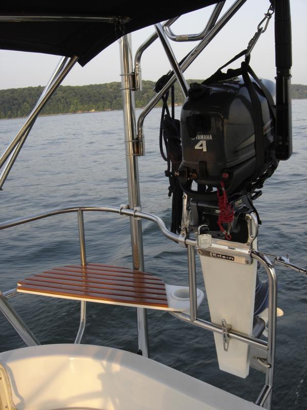

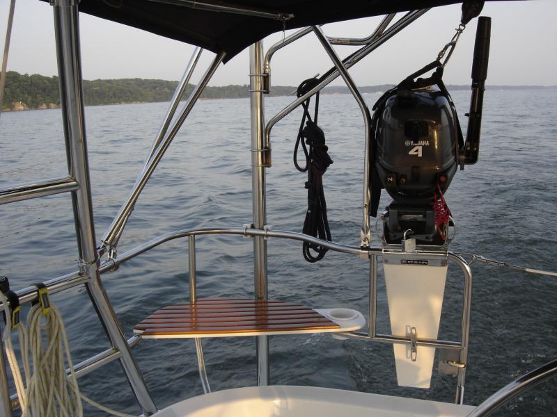

I don't see this in the WM catalog. Do you have any more details about the part?

Should be in catalog but was in the store the other day and saw one,I think they have changed it a little bit but from what I saw it does the same thing and I paid 29.99 back in 2008 and I think it is 34.99 but not sure.
Go to a WM and ask it but not the $$$$$$ one but the cheaper one and it's all white plastic with 4 bolts holding it on the railing.
