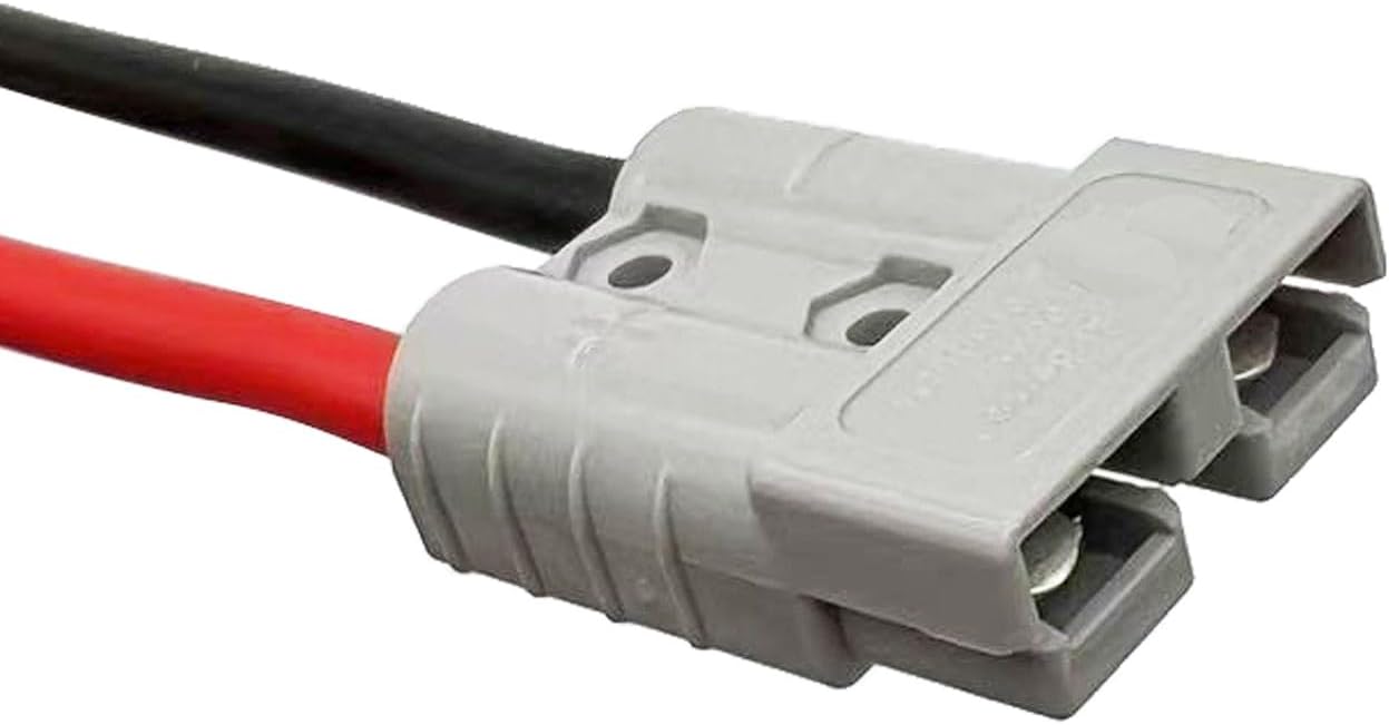

Mar 6, 2008
1,518
On my H25.5, I installed a plug near the engine. I purchased the plug from a trailer store. I believe it was used on gulf cart battery cables. The contacts were rated 50 AMPS.
