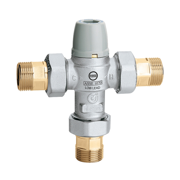

You need to add a thermostatic mixing valve...

Nope.... Sadly it has been legal in the US for boat builders to connect the water heaters HX to a source with 180 degree plus water in it for years. That is FINALLY changing in the next revision of the ABYC standards.
This sort of nonsense is NOT allowed on shore and should have NEVER been allowed on boats, but it has been. Feed a 6 gallon water heater 180F engine coolant for long enough and guess what, eventually the water inside the water heater gets to pretty much 180F.....:cussing:That temperature would instantly spell lawsuits on land but on boats folks just seem to accept it.....:cussing: It is simply flat out dangerous to not have a means of tempering the hot water coming out of the water heater...
All boats with a heat exchanger water heater should have a thermostatic mixing valve whether required to or not.
Some of my customers have massive diesels that run at 200F not 180F......:doh::doh:

Is there a thermostatic mixing valve specifically made for boat use or do I just get a normal one from plumber's supply place ?
Feb 6, 1998
11,722
Any domestic hot water heater thermostatic mixing valve will work... I usually use the Watts 1170-M2 1/2" tempering valves...

Here is a "Point of USE" mixer valve that requires 0.5 psi to operate properly. However, the costs are still high $ 250. and up! I think ill use the old-method of touchy-feely..lol
