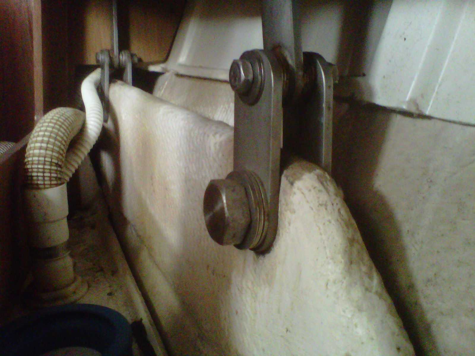

Its been quite a few years ago that I last posted/participated on the Cherubini forum. Back now!

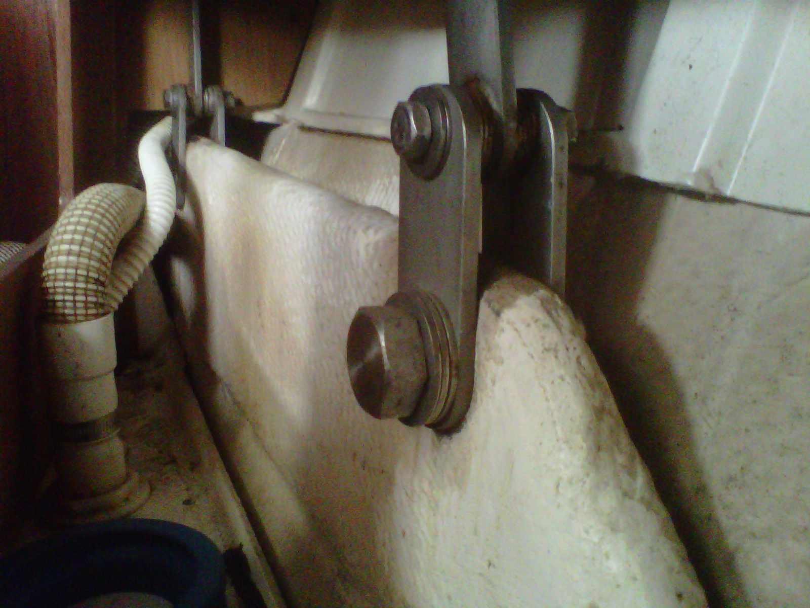

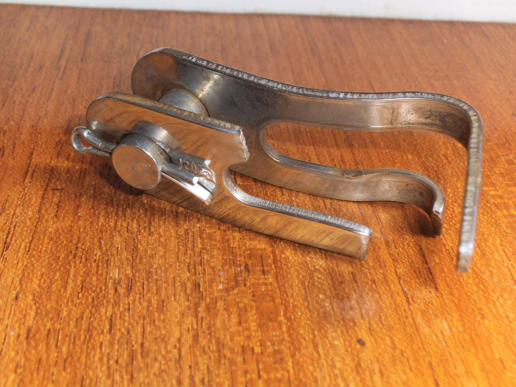

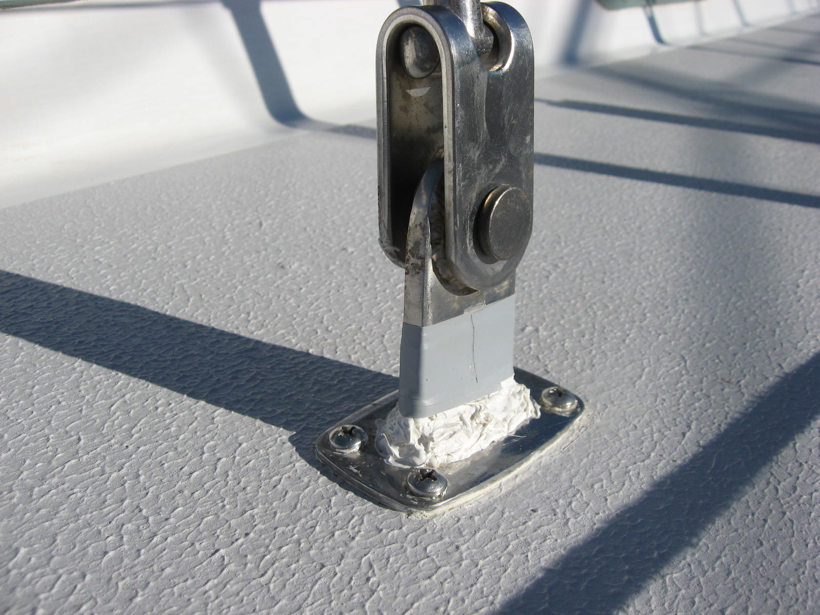

The attached photos show the outside/inside chainplate arrangement of my 1980 Cherubini Hunter 36. Based upon what I can actually see, the SS metal still shows no signs of concerning problems. But I have read that in the area underneath between the caulk bedding on the deck surface and the interior, out of sight within the deck core, crevice corrosion may be lurking. Not only Cherubini Hunters. Pertains to all boats of this vintage.
Before I pull a couple of chainplates to really take a look: Has anybody done so? If so, what did you find?
And: Any chainplate failures to report?

Dalliance, I wish my trim plates were welded to the chainplate -- as so many boats have. As you did, I also tried several types of sealant/caulk over the years. All would fail in a year or so. Eventually settled on roofer's gutter caulk after noticing the stuff on my home's gutters was still doing its job a decade later. And was a lot cheaper than marine specific stuff. On my boat, for added security, after applying the sealant, then after it dried, but before the next sailing outing, I wrap tightly with UV resistant electrical tape. This step helps prevent the sealant from separating from the chainplate as shrouds flex while sailing.

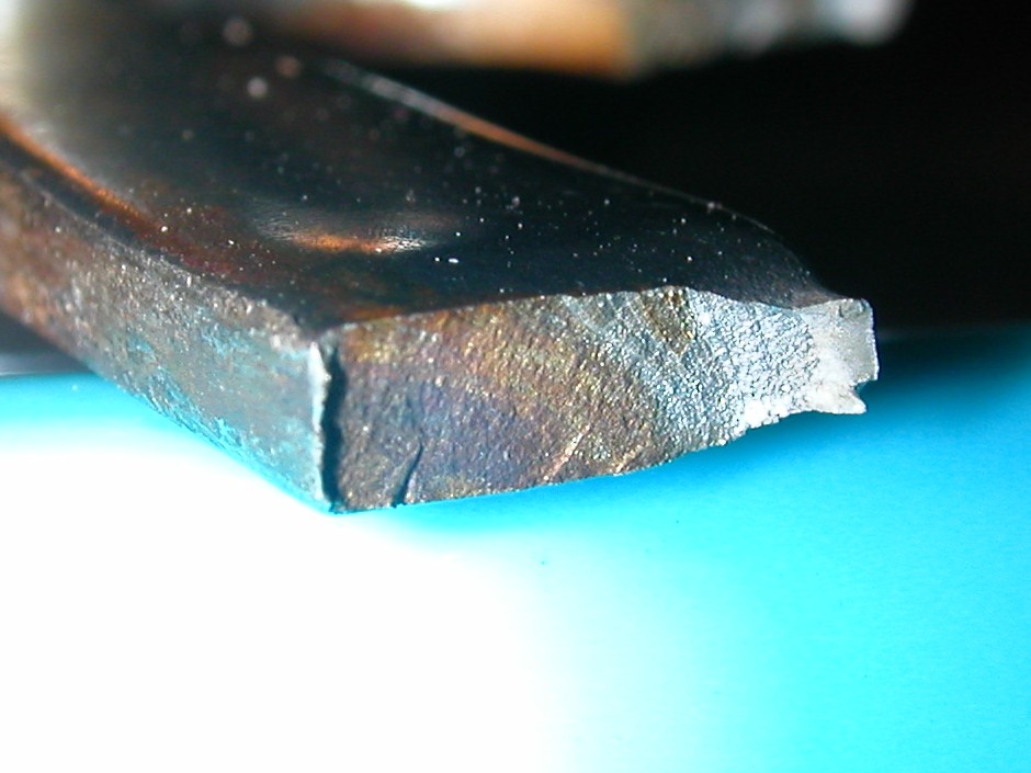

A few years ago had a chainplate on my '77 h30 snap while under load. That's when it is going to happen. Shook the boat so hard I thought I had hit a submerged object. Was lucky to come about before the whole rig came down. Nothing on the outside of the plate showed any sign of corrosion. However, the interior was completely corroded. Replaced all six plates. Couple of years later, on a downwind run, the stem head ( bow chainplate ) snapped. Same issue. If in doubt, spend a few boat bucks and replace. Any machine shop can fabricate them for you.

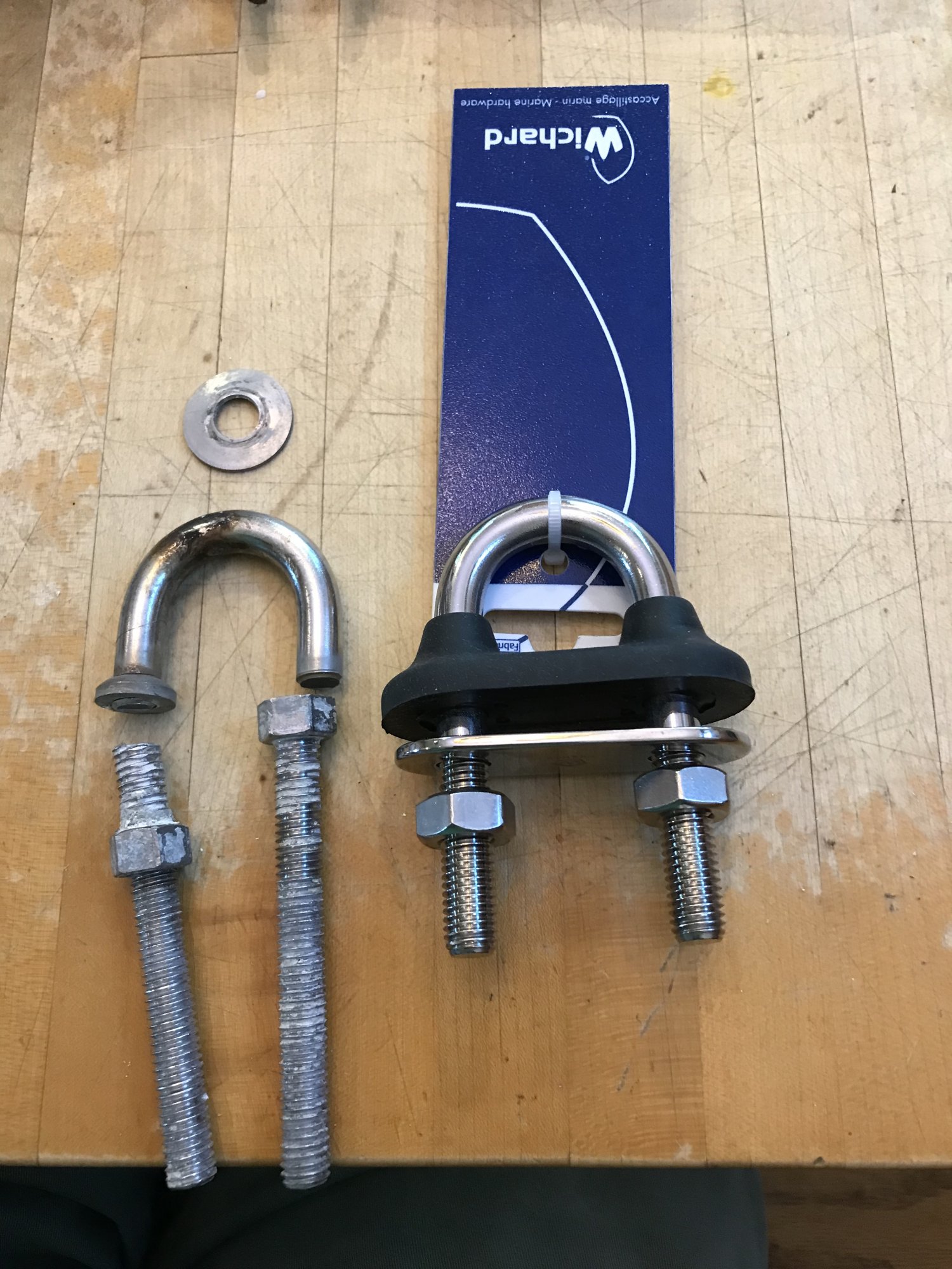

My 1980 h33 had one of the U bolts on the split back stay fail. Hunter U bolt was an inferior design with the deck shear point on the threads. Replaced both with properly designed U bolts from Wichard.

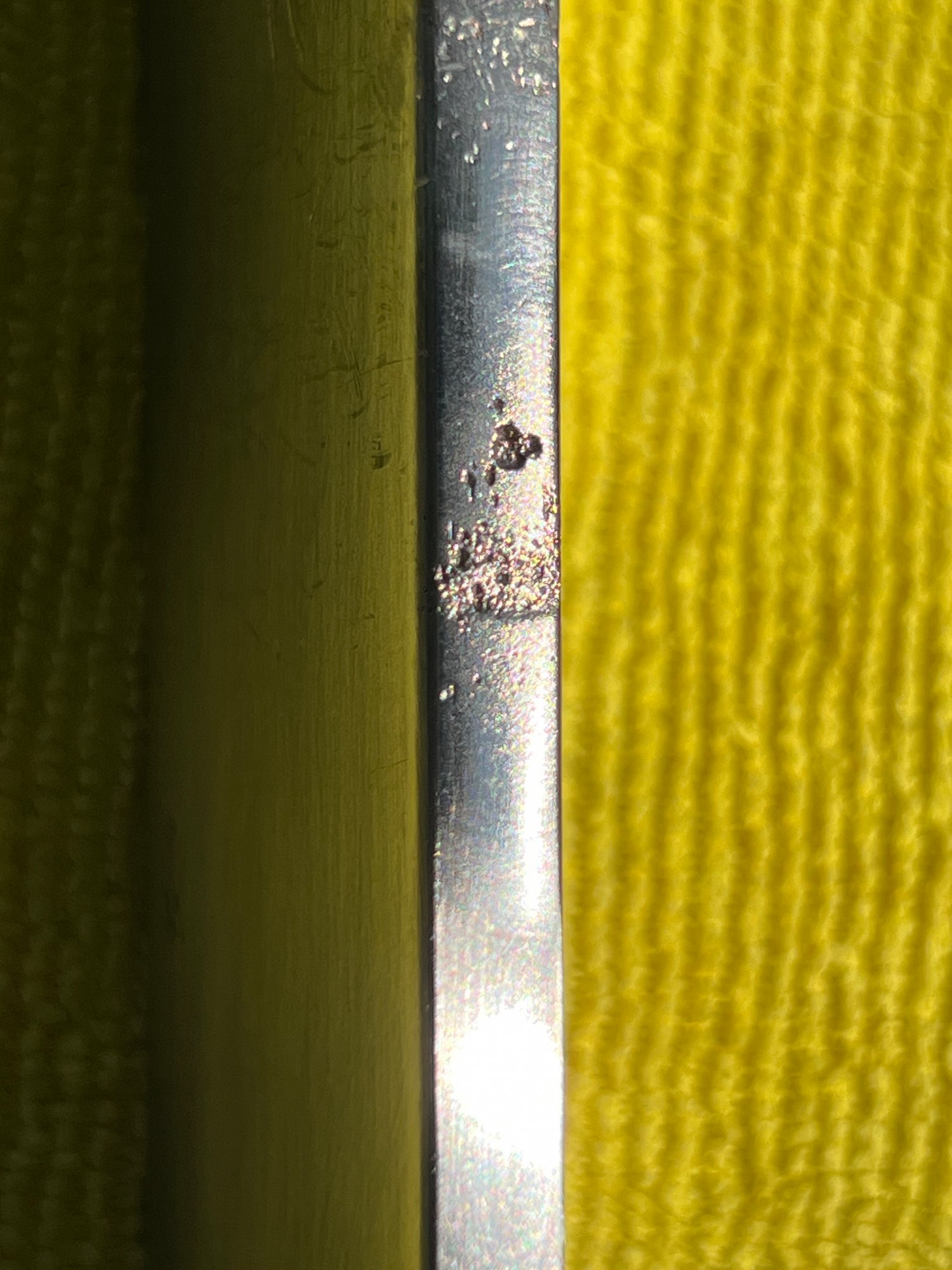

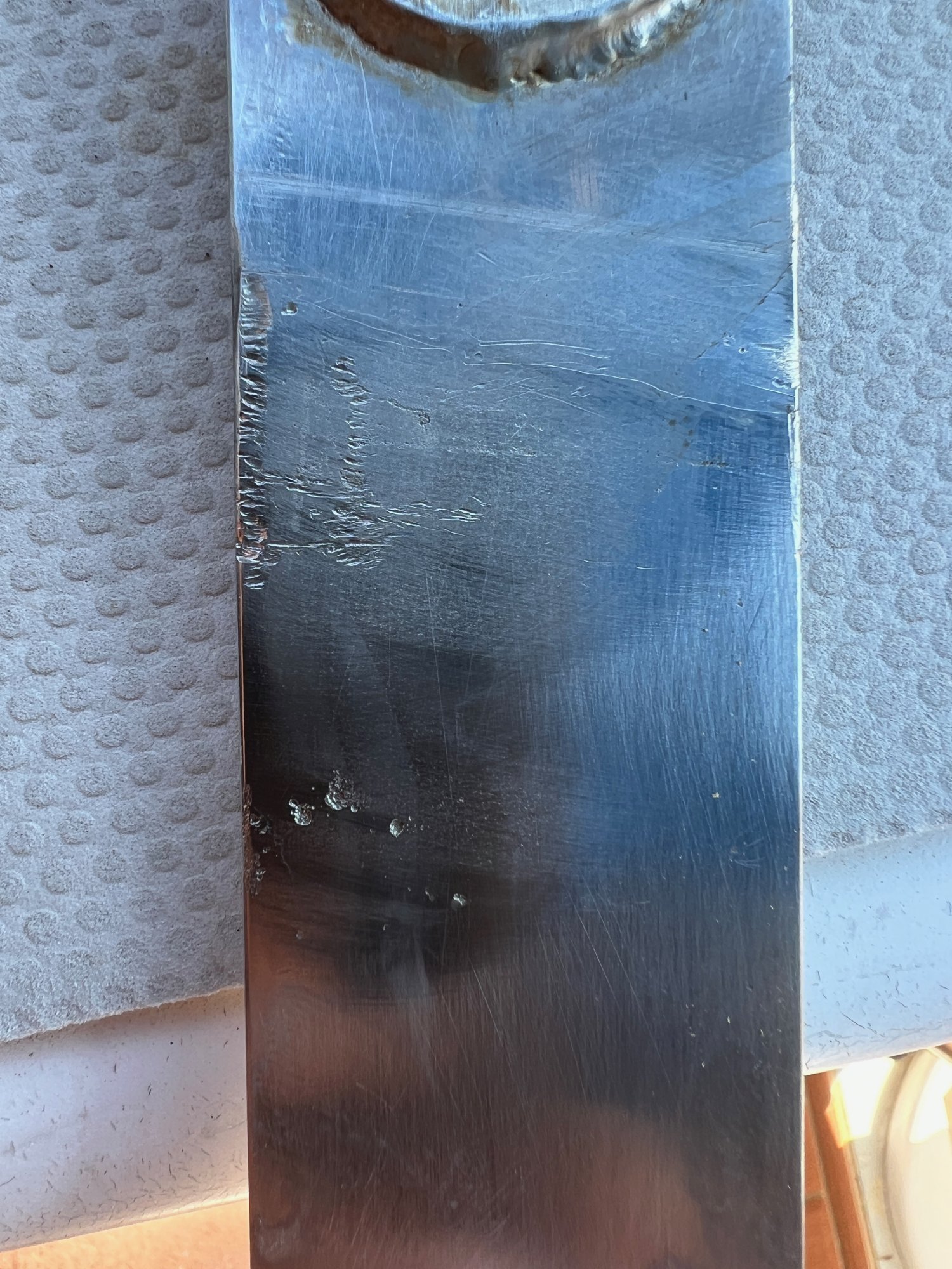

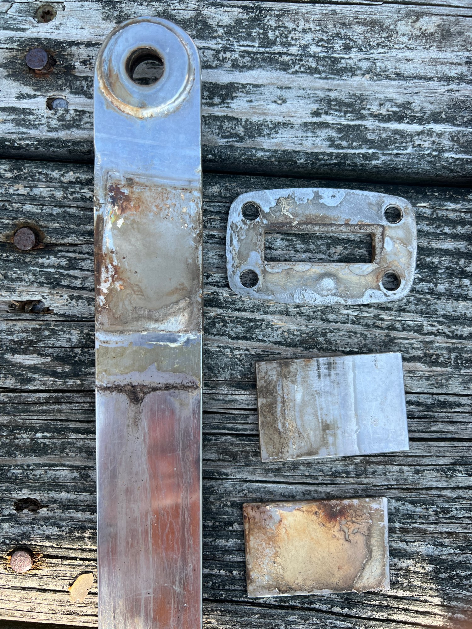

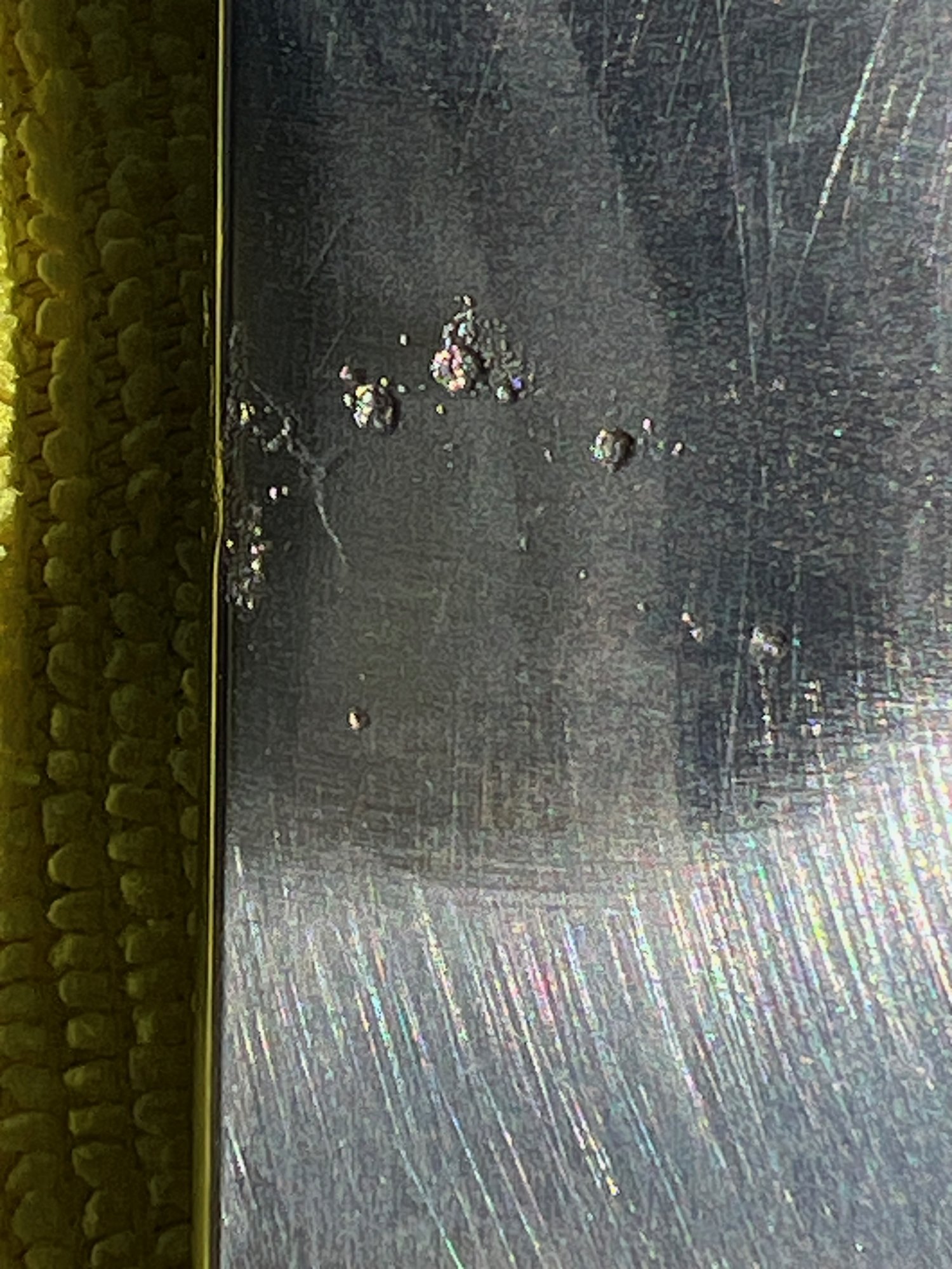

Yikes - yeah the backstay U-bolts are also on my list. Thanks for the tip. Seems like a much easier job than then chain plate. I removed both the aft lowers, used some spare halyards to support the mast in their absence...also loosened the other stays. Both had some small pitting, not sure it's crazy bad, but will likely source some replacements. The area on the port side where the plate goes through the deck is next to a water tank fill port. And all the wood underneath is toast. I had a 6' section of that area re-cored years ago but the yard didnt do that small area, I guess they didn't want to mess with the chain plates. So I need to remove that deck sheet and replace the core. Will be my first attempt at such a fix, luckily it's a small area I need to replace....here are some of the shots of the pitting. Scary? Dunno.
