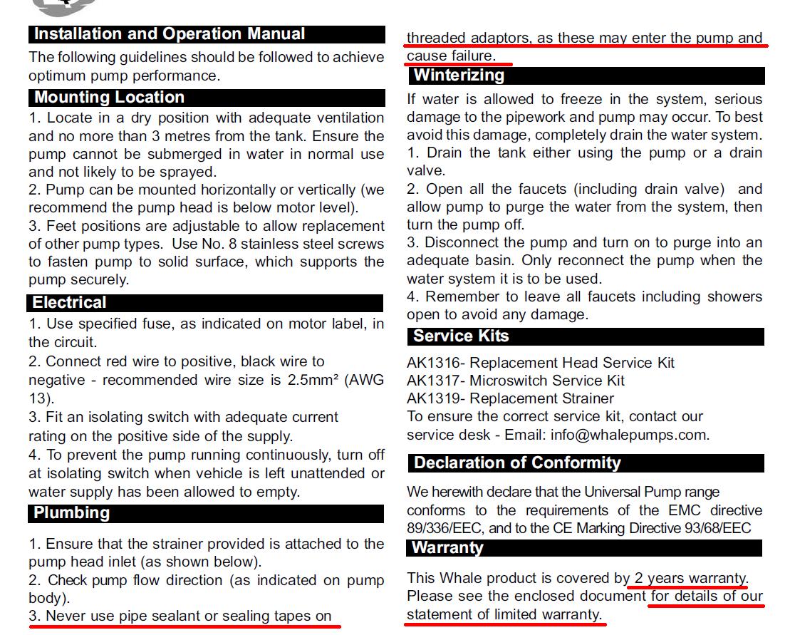

Exactly as you say. I also highly doubt you used pipe dope on any screwed fittings and fouled the sensor ?
How did they manage to avoid the two year warranty with their statement of limited warranty ?
The pump has quick-connect fittings for inlet and outlet hoses. No pipe dope or Teflon tape was used.
