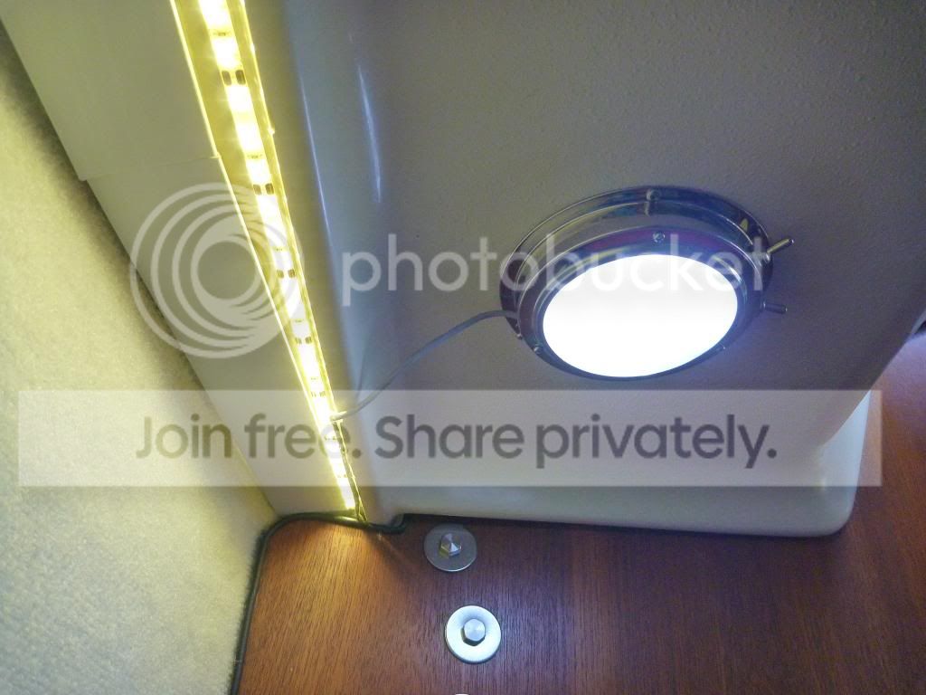

I tucked my wiring up under the head liner, as Ward said, it works very well.
Also I covered the gap with the excess slats from my 2" wide white plastic blinds (in the house), I cut them into about 8" long pieces. I stuck them on with a piece of hook and loop tape about an inch long on each end. Worked great.
There was enough FG room for strip led lighting to go full length both sides of the boat.
Hope this helps your idea's.
