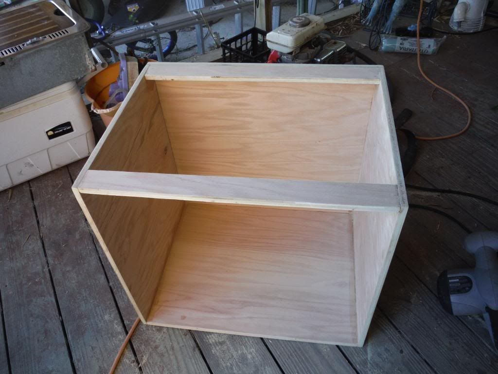

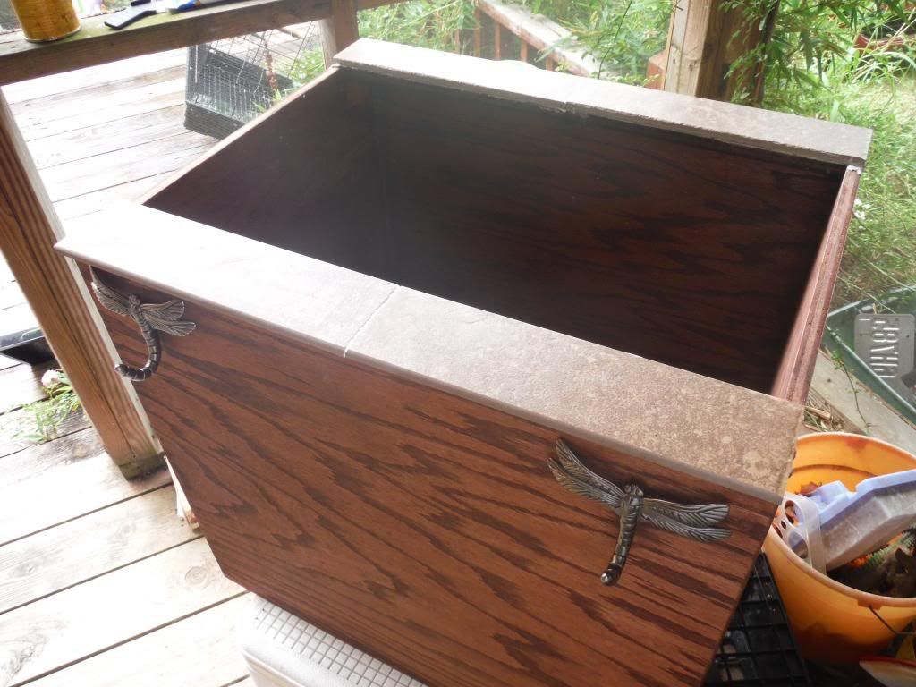

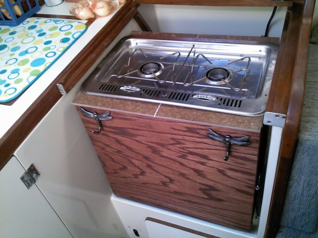

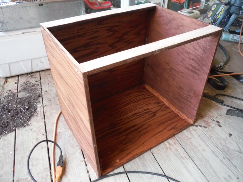

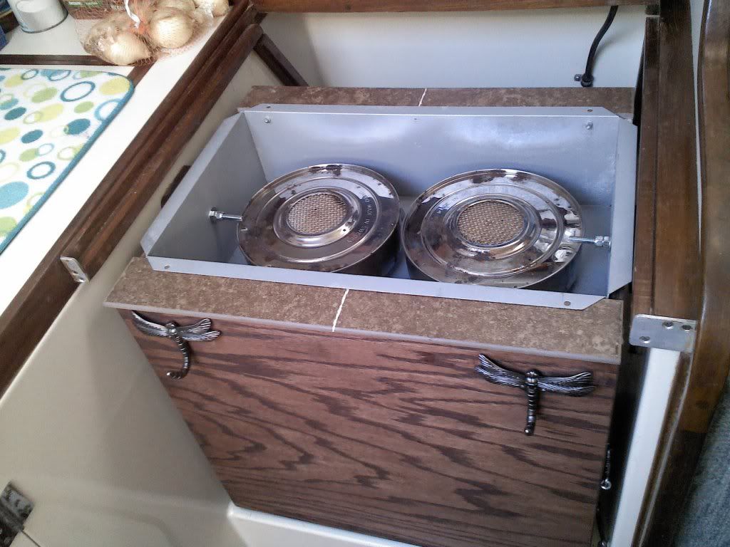

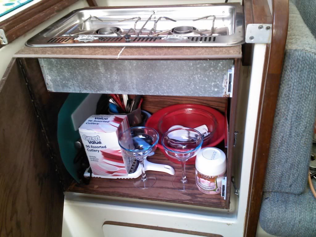

I took the Hillerbrand three burner stove oven out and built my own gimbal cabinet to hold a Origo stove. I don't need the oven.
For the gimbaI just used carriage bolts in the same place as the Hillerbrand and the heads slid right in after I had lock bolts on either side of the stove cabinet. Added more storage and is very safe on passages.
