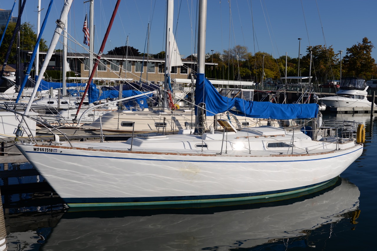

Hi all;
I have a 1973 P36 sloop that has been previously used in a sailing school. It has not had LP on board for many years but I would like to add that back in. I'm wondering if anyone might know where the LP tank(s) were originally located on this boat.

During those years pressurized alcohol was King. It is likely that your boat never had a propane system on board. As you probably know Propane is heavier than air, flows like water, pools at low spots and is explosive in large concentrations. Propane tanks are installed in a sealed locker, vented at is low spot to the outside of the hull. Look for such a locker but if none is found it is likely that the boat never was equipped for propane. It could have been equipped for natural gas and tanks were usually located inside the cabin as CNG is lighter than air and will dissipate rather quickly but the popularity of the fuel in portable tanks fell into disuse by the general population and it is currently in the last stages of being phased out for small boat use. Being the fact that the cost of a proper propane installation nowadays may run into a couple of thousand dollars many are returning to denatured alcohol. Origo makes non-pressurized stoves which perform rather well and run on denatured alcohol which can be obtained by the gallon at any hardware store. These might be your standard choices as many have developed alternative systems hanging propane tanks from the stern rails, adapters to stealth fill CNG tanks at motor vehicle stations or running camping stoves. For those live aboard with access to shore power an electric stove is a plausible consideration. Nice looking boat but I personally would refrain from a propane system upgrade unless I were to become a full time cruiser.

Thanks for the great and informative reply. I did not know that LP was a more modern thing. I assumed that it has been around for a while. We are planning on moving aboard in two years so I will be spending that time upgrading her to liveaboard condition. I would go with your recommendation of alcohol except there's no water heater either. I was thinking about adding an on-demand LP water heater (since there's no heat exchanger on the engine) and an LP cabin heater while I'm at it. LP seems to be the most universally available fuel. I am considering whether I should mount the tanks in a locker just aft of the mast or in one of the pre-made lockers that fit into a lazarette. I am reading up on the ABYC standards for an LPG installation and would be installing a "sniffer" alarm in the bilge.
