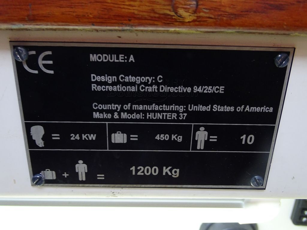

I have a hunter 37c under offer in the UK. It's been given a Cat 'C' CE rating (see photo .1) on entry to the UK in 2007 because the owner at the time didn't pay for a full RCD assessment. I'm trying to build a case for reclassification as this is obviously a miss-classification as a Cat 'C' CE is defined as :
'Designed for voyages in coastal waters, large bays, estuaries, lakes and rivers where conditions up to, and including, wind force 6 and significant wave heights up to, and including, 2 m may be experienced.'
  • My first question is; what was the original design category of the hunter H37c? *(Any and all info is great but I really need documentation of some sort to back this up)

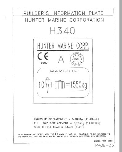

  • Secondly if anyone dose have supporting documentation (example see photo 2.), most likely to be found in the original users manual (ISO or CE) a decent quality scanned copy would be hugely appreciated.
