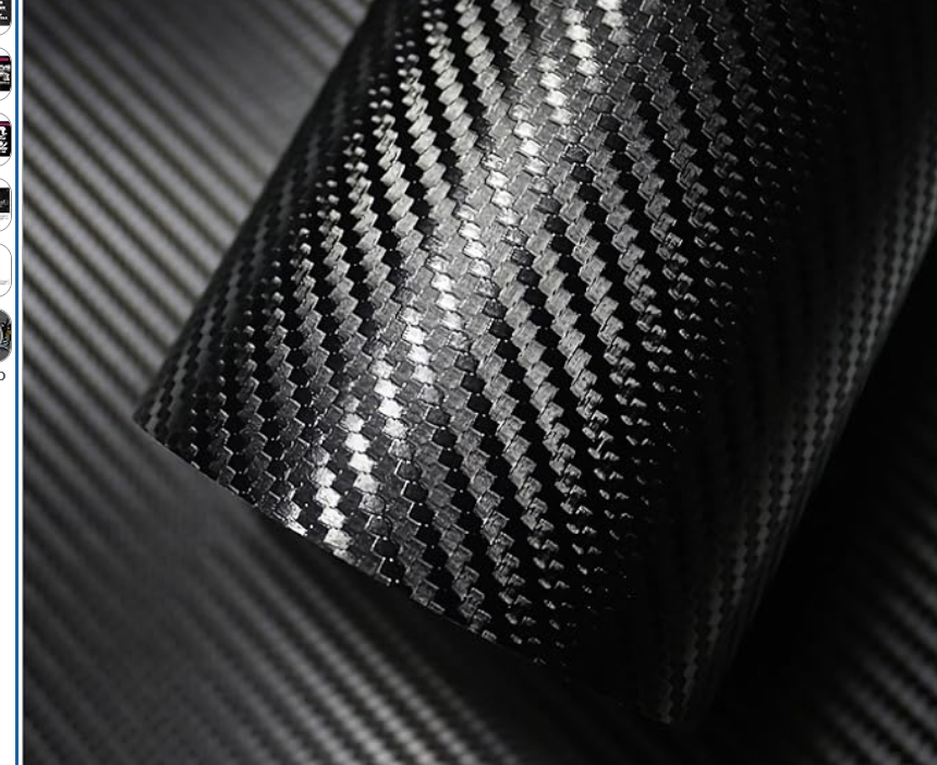

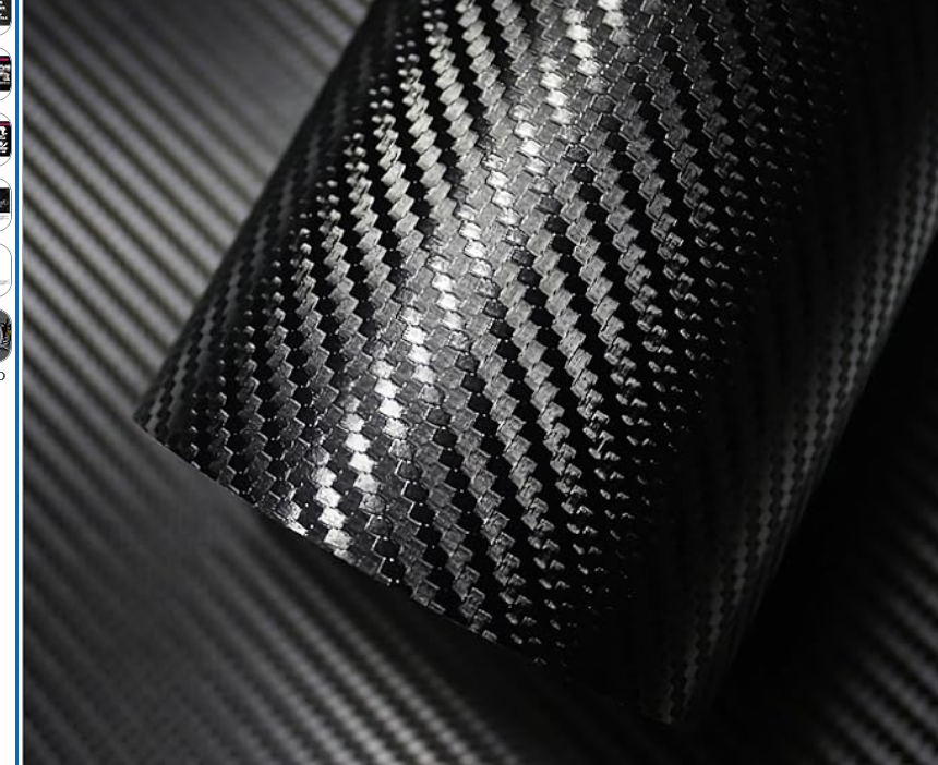

Imitation carbon fiber wrap.
I am not kidding.
i think it would be a cheap fun experiment.

New ideas like the carbon fiber wrap or a vinyl wrap in lieu of paint might improve the look.
