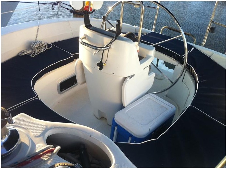

I saw a bunch if really nice new sailboats at the recent Gulfport Boat Show, which got me to thinking...
The obvious trend in coastal cruisers has been for wider cockpits to include rounded cockpits. While great for seating at dock, does this present a challenge when heeling over under sail? Doesn't look like there's a way you can reach out and brace yourself too easily.
I've some comments in favor of and against rounded cockpits, and a comment that Hunter was going back to straighter cockpit benches.
What do y'all with round cockpit experience have to say (good or bad) about these nice looking rounded cockpits?

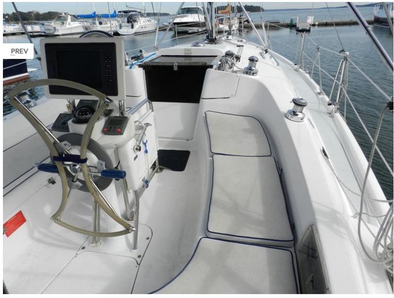

No knowledge of the newer models, but I see that the attached 2002 H35.6 has straighter backs when compared to the 1997 model.
They both look nice, but my wife is not so keen on the curved cockpit judging by photos--concern about leg room for people sitting next to each other on either side of the curved areas. -- if that description makes sense to you all.
Haven't yet gone on to look at other manufacturers until we suss out the curved cockpit issue for our wants/needs. The discussion here has given us much food for thought.

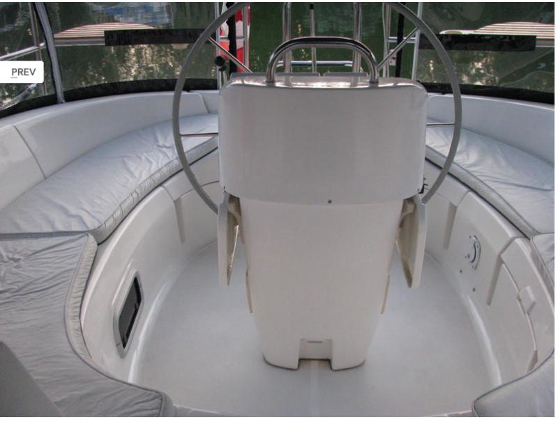

on our last trip to the BVI we chartered a Bavaria 40 with a rounded cockpit. Not one of us could get completely comfortable when the end of the day came or early morning. Trying to sit and read a book or write in a log was almost impossible. When sailing in late November with the Christmas winds we quickly forgot about the curved cockpit.
Pat makes a VERY good point, and one that Jonny Q should check out very carefully, regardless of the shape of the cockpit.
One spends, or hopes to spend, a LOT of time in the cockpit, I know I do. I really, really, really appreciate the comfort of the cockpit on my boat.
1. The back of the cabintop is slight slanted to make a good, actually GREAT backrest.
2. The coaming height when seated leaning back against the cabin is the PERFECT height for an "armrest" for reading.
I've been on bareboats where the back of the cabin curves into the coaming (whether the seats are straight or not is immaterial in this instance), and there was simply NO way I could get comfortable leaning back there, because half of the backrest was taken up by the stupid curve.
Also beware of straight up & down cabin houses. It's very uncomfortable trying to lean back if there's no slant.
So, Jonny, I don't think curved or not may be the most important issue. Just sit down and pretend you want to read a book and see how comfortable it is.
