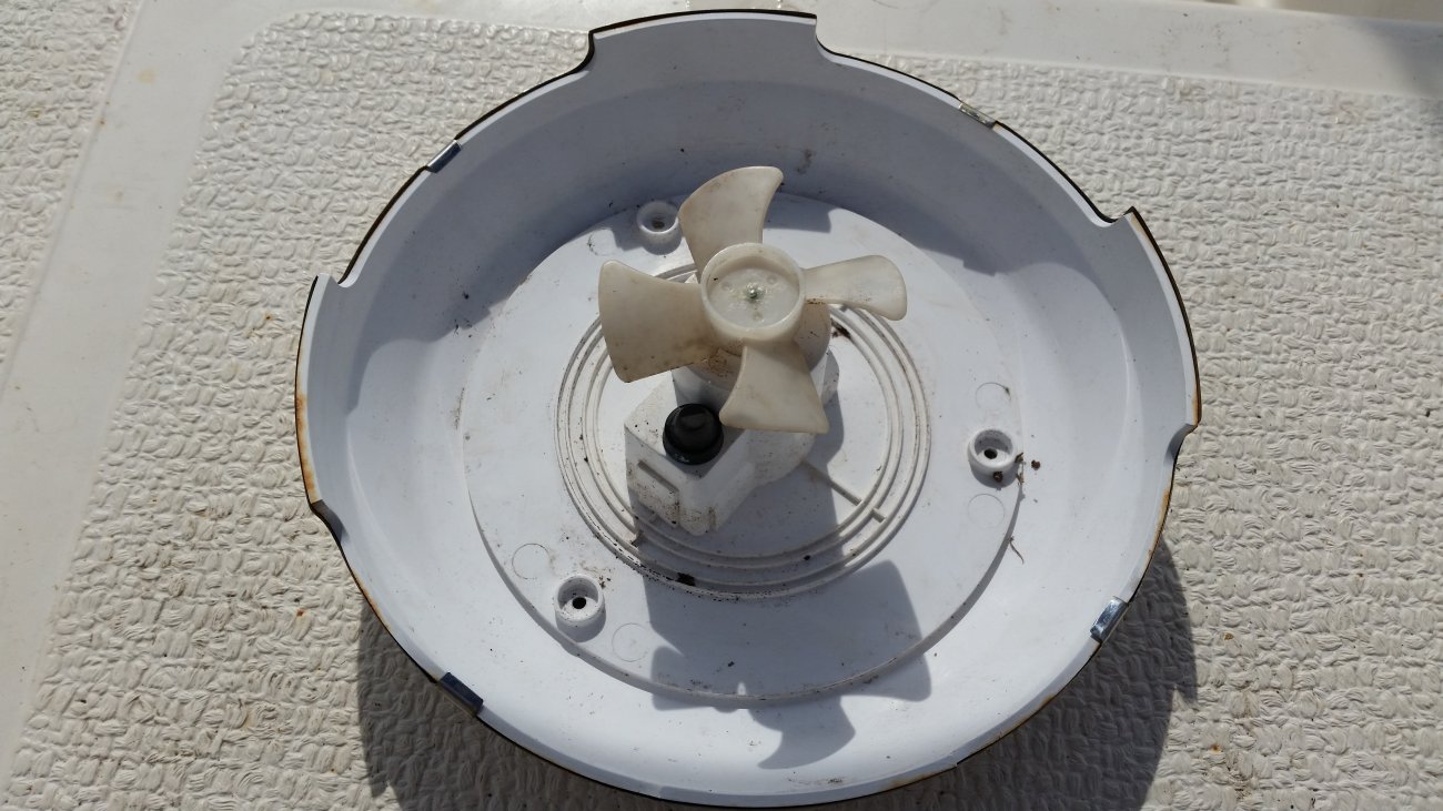

Not sure anyone is here but I am looking for information on my Nicro solar fan that doesnt work. It will spin easily by hand. There is a black rubber on off switch you push but no way to know when its on - if it works and its sunny I assume it will come on right away or very soon. There is mention of batteries here - I see no compartment for them. Are they back up or needed to run the fan? Photo included. I do see to check on Amazon and other sites which is helpful. There is a 3.5" hole in the deck for this and I hope something matches that ( dream on, right?)

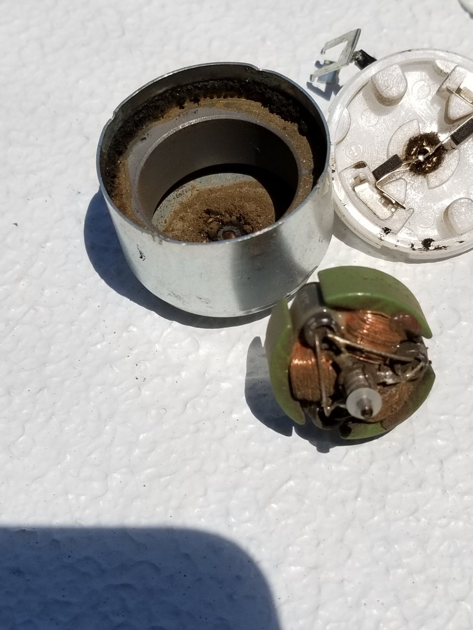

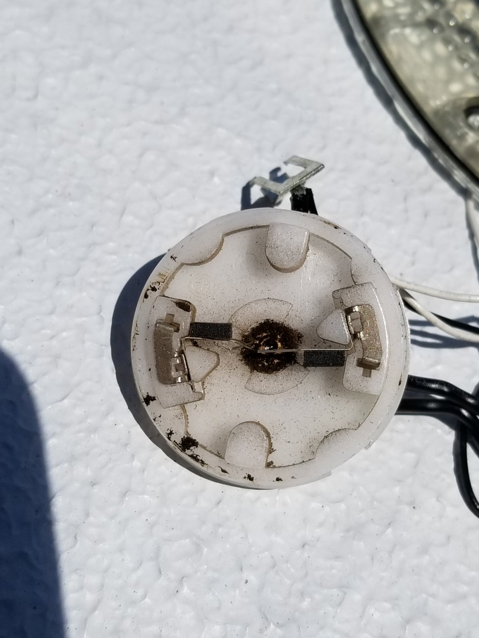

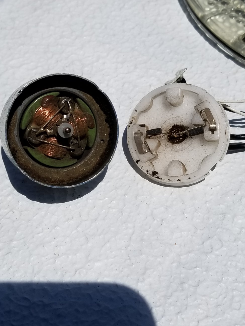

My Marinco/Nicro solar vent has the same problems as others have expressed. Fan will not turn in direct sunlight. These vents are designed to operate even with a dead battery when in the sun. My battery was fine and there is no rebuild options available. So I decided to dismantle it to get to the motor. The motor casing is secured to the plastic end cap with 4 crimp connections. With the cap off I found a lot of fine debris inside the housing. Also, the tiny wires that rub against the center rotor were bent and worn on one side and looked ok on the other. I cleaned it up, lubricated it, and put it back together. Has worked fine so far, but I expect to tank any day now. Here are some pics:
