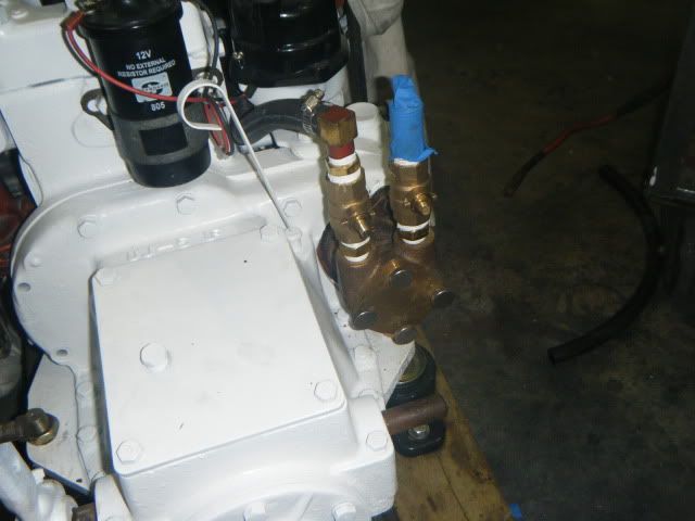

There are at least 3 different sources for Atomic 4 electronic ignition systems: as you said Moyer Marine, Indigo Electronics and Pertronix (I think the Moyer unit is a Pertronix). I changed mine a couple of years ago and it has been trouble free but my points system was trouble free too. I made the change for fewer parts to fail and no parts to wear and replace.
When considering the upgrade, a critical aspect is to replace the coil as well. The electronic system requires a different resistance coil than the points system (3 - 4 ohms for the electronic). Not changing it risks damage to the electronic module.
My Pertronix system came with a replacement distributor plate so I could keep the old points and condenser mounted and adjusted on the old plate for a quick change backup if ever needed. I'm not sure but I understand the Indigo does not include the plate.
Another plus, with the Pertronix system there's no need to remove the distributor, the change can be done in place.

I did the Pertronix and liked it the coil is just and internal resistor unit
