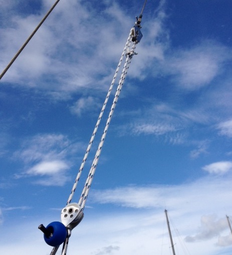

PS -- here's the topping lift block and tackle attached to the end of the boom. I can release the stopping ball which is inside the d-ring gate and release the tension on the TL some more while under sail. Then haul back up on the TL adjuster by placing the ball back into the d-ring gate for the optimum position to clear my bimini.

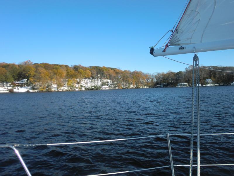

That's some heavy-duty topping lift assembly for a 27' boat! I've just got this little-ole block. Yep, the photo shows my line way slacked off hanging below the boom. It's not normally that slack. I'm thinking more like Joe now ... a rigid vang would be so much cooler:2cool:.
Calling up this photo has got me thinking about how much more comfortable I was sailing that day after an 18-inch snow storm than I was this past weekend with 95 degree sun baking on us!

Hah! It's not really heavy duty, it was a left over block with cam (correct term?) probably for a flag halyard--small diameter. Don't have the deck hardware to run it anywhere so this was the cheapest solution (free!)
