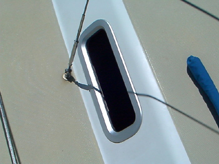

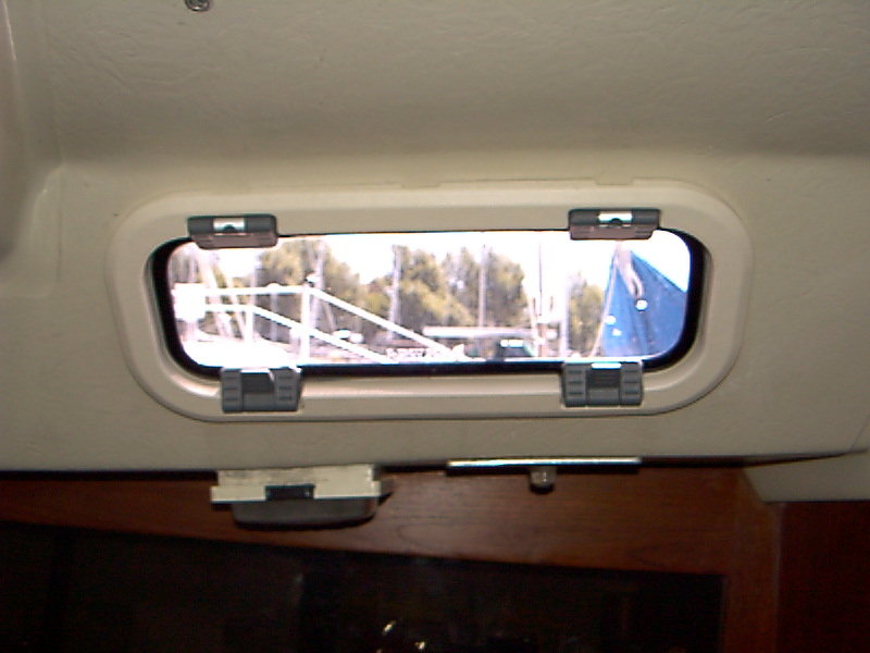

Use butyl tape
My Lewmar opening port installation was pretty much the same as you mentioned except I used butyl tape (putty tape)to seal it. It is not messy, no clean up required. If you should ever need to remove the port there would be no problem. The old slider window had a couple of big gobs of silicon sealant under it, applied rather sloppily. No wonder it leaked! Two pics to follow...
