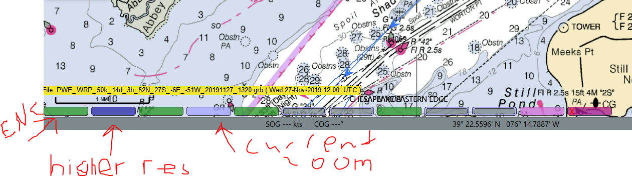

I next have to get the zoom tweaked. Chart detail seems to come and go with the zoom
It will automatically select the right scale chart based on your zoom level. When you're at the zoom level you want you can override the automatic selection by clicking one of the rectangles along the bottom of the screen. Each rectangle represents a different chart for the area you're viewing. Higher resolution charts are on the left of the bar, and lower resolution on the right. Raster charts are blue boxes and ENC are green. Hover over each rectangle to see what chart and scale it is. The rectangle that's an intermediate darkness is the one you're on; darker shades are higher resolution, gray with a colored border are lower resolution.
Also, if you want it to default to using higher or lower res charts, you can tune the default levels by going into Options -> Advanced. There are sliders there and moving them more to the right will default to higher res charts; left for lower res.
