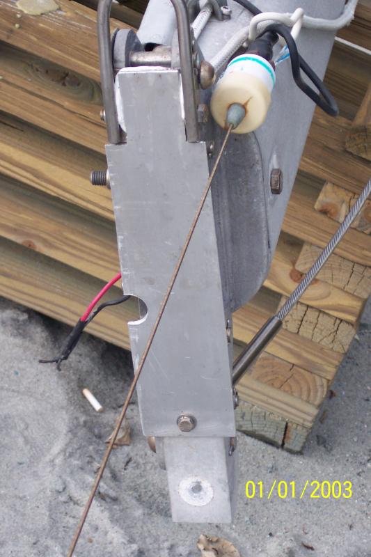

A buddy has a C30 and pointed out that his masthead is open - you can look down from the top at the masthead sheaves. Is this typical? Seems like an unnecessary water pathway and hard on your sheaves and wiring even if it drains out at the base of the mast. He found it because he unstepped his mast due to a leak down his compression post. Thanks.

Just had our Mast pulled, rigging inspected, LED Lights mounted...also installed a new plate to cover the top of the mast.

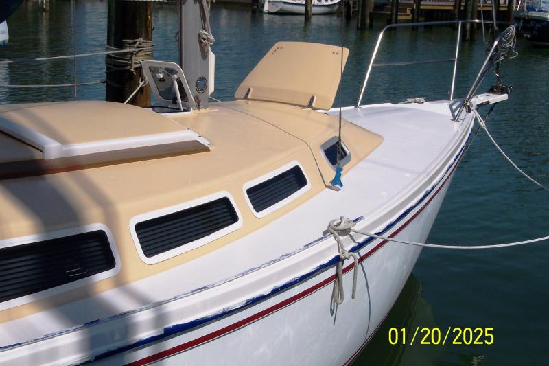

My mast crane had cracked. I replaced this & also decided to fabricate & use a close-off plate. An open top I feel is what causes cabin-top sag at the base. My base plate wasn't properly sealed, no drain holes in the mast & the electrical wiring pass thru was installed poorly. All of which lead to some major repair work. But now, I won't have this problem.
With the new top, I finally added a mast tube for wiring and conversion for my halyards to run inside the mast. No more clanging of halyards & wiring. I also added a 3" dia. vent plate near the bottom of the mast on both sides to vent any moisture buildup.

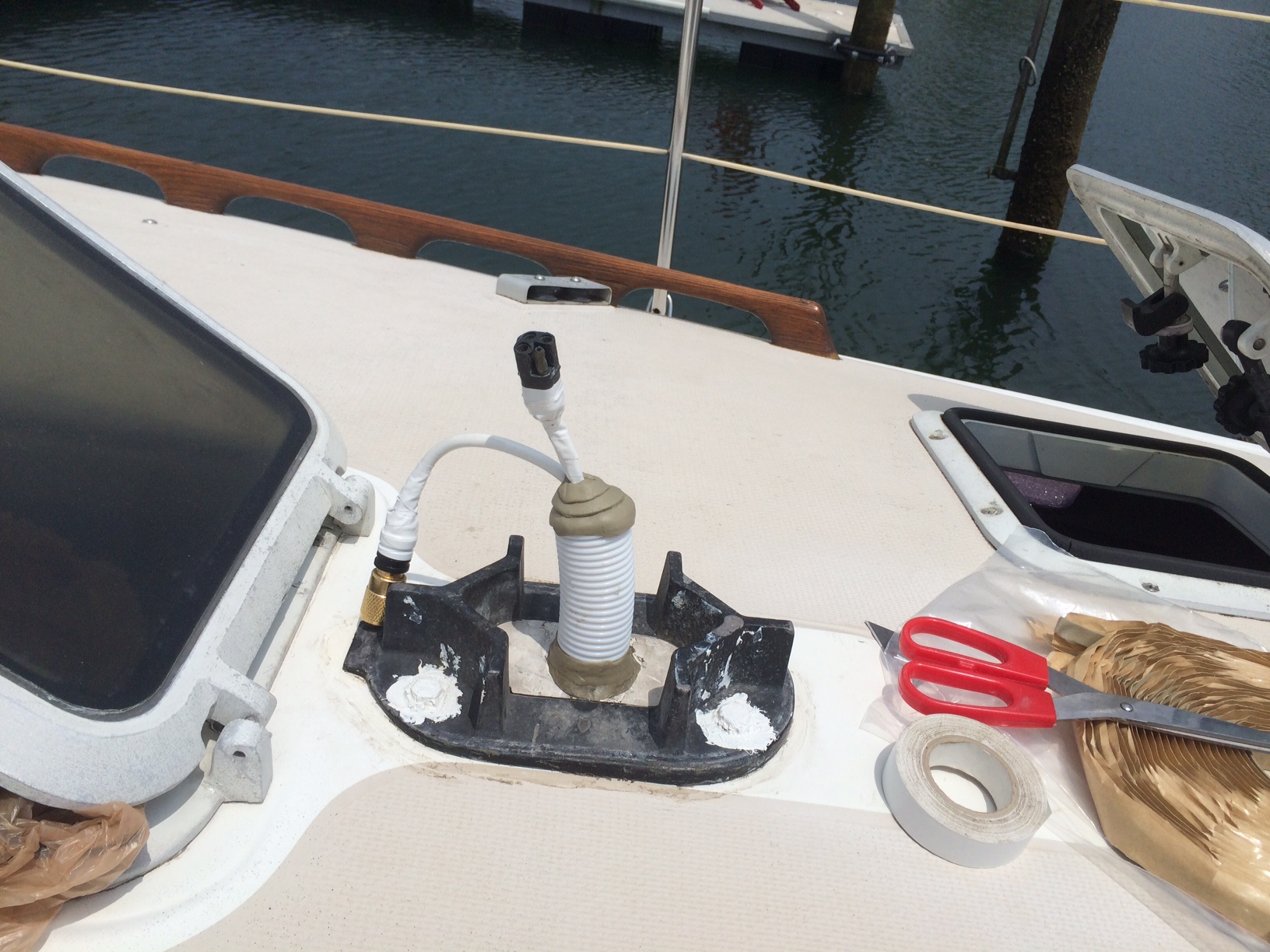

I did the same on the mast step plate to allow drainage of any water standing inside the cast aluminum plate & from any space between the plate & the inside wall of the mast. I don't want any water to sit for any length of time. I had a 1 1/2" CPVC vertical pipe (for my cabin-top pass-thru wiring) 3" high glassed in when I repaired my cabin top mast sag. To this I added a 180° CPVC slip fitting on top of the tube (this fitting is not glued for easier fishing of the wiring.
This way, when my wiring exits the mast tube (attached internally to my mast) then, I pass the wiring thru the 180° fitting & down my glassed-in CPVC to my junction box in the head. This keeps any water from seeping into my coring.

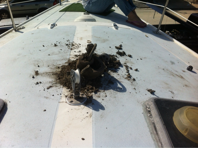

I will be fabricating a cap for mine in the next month or so as well. My mast was full of dung when it was unstepped. Nasty.

I believe all C30's are deck stepped. I know mine is. It's open on top too. The opening is maybe 2" x 10" wide. I wasn't sure how much would really get in there. Seeing I'm stepped yearly I don't see much but the dung in Garbone's mast would make me want a cap. Yuk!. You Florida folks pull your mast maybe once every decade? Mine is down and was thinking should I. Last year I added a deck plate and black anodized the deck plate. Thanks, always appreciate your comments and advise.

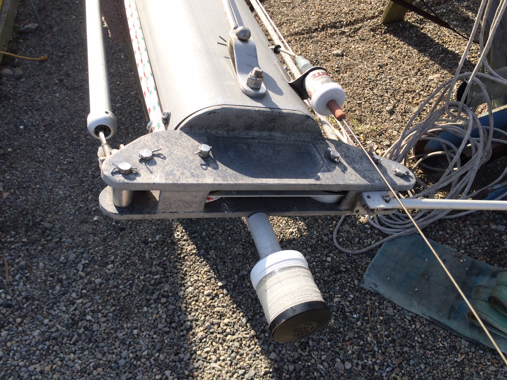

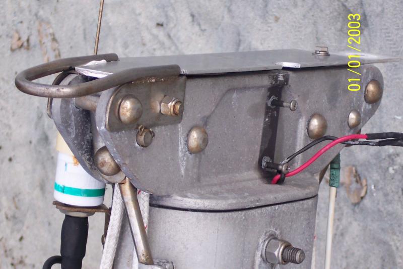

I put a plate on top of mine also. The wind instrument and wind indicator is mounted to it. It covers the whole slot on top.

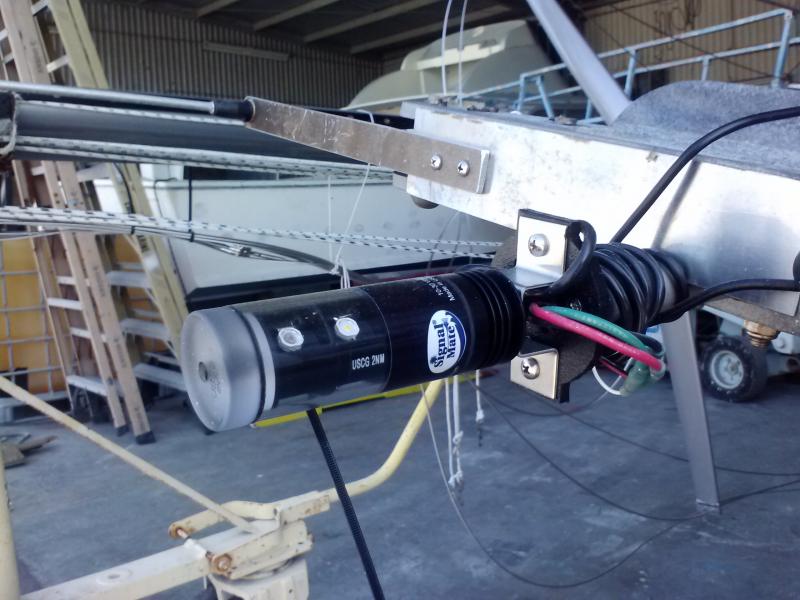

Does anybody happen to have a dimension drawing for the mast cover plate that you made? I see Ron's boat has a (spinnaker?) bail on it, which mine lacks, but I believe all of us have a comparable cast aluminum head (except early 70's boats).
I'm mostly interested in the location and diameter of the anchor light cutout.

That brings back memories.... after seeing water in the cabin coming through the compression post??, I took the mast down and redid all of the sealing at the step, replaced lights, cables and halyards.... resolved the water in the cabin problem for almost a year, and back to the same issues again. Does not make a lot of sense to me anymore, but a cover certainly does! I assume that it is aluminum, what is the thickness and how does it attach? Since I will most likely take the mast down again, I wanted to get all of the parts ready. Thanks a lot!
