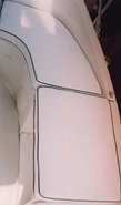

You are correct............closed cell foam is water proof and will not absorb water. Closed cell foam also floats – if your cushions go overboard they will not sink and can serve as floatation devices if a crew member goes overboard unexpectedly. Closed cell is hard – not as cushy as you might like to sit on, but very stable for walking on when you go to reef a sail, etc. They are very durable , hold their shape and resistant to mildew, rot, and UV rays. More information here: Cockpit Cushions: what are my choices for materials? - Sailing Eurybia. Also suggest covering th closed-cell foam with Sunsure, a woven fabric made with PVC-coated yarn. My cushions have 2" closed cell foam covered with Sunsure and look like the ones in the photo below.

Thank you for your response! If you don't mind me asking, where did you get your cushions from?

Closed cell foam is not at all uncomfortable in my opinion. I also like the fact that it holds its shape/
