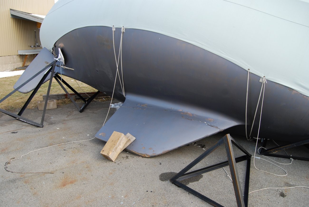

How about the fact that the boat could not have been blocked in ABYC practice because the bow was over a bank? There could not have been a stand in the first 10' and no stand at the bow. I could be seeing it wrong. They did this to save yard space, I imagine. But this obvious shortcut puts all of their blocking practices in question.
If LM removed the stands before careful inspection and photography, that is very suspicious and hard to defend. Combined with the absence of bow stands, yeah, they knew it was blocked wrong. As a judge I would be leery of any explanation. There are any number of details that could have been missed, such as no padding under stands, incorrect spacing, or chains that were not tight or missing. If it were actual stand failure you can bet they would have recorded that.
ABYC also says one stand very 10 feet, but I wonder as the size of the boat goes up, if this should not increase, since the windage, and more importantly the momentum if it starts to rock little, goes up in more than direct proportion to length.

@TomY The proximal cause was a storm with ~ 40 mph winds. I don't think there was any one fatal flaw, it was a combination of several factors:
The boat faced NW and in close proximity to the barn. If you stood on the foredeck, there was no land between the boat and Toronto some 130 miles away. The wind no doubt hit the barn and buffeted the boat with apparent winds in excess of 50 mph.
The asphalt surface was solid, but not perfectly level. Water and ice may have gotten under the jack stands.
The cover added windage.
The number of jack stands was marginal. It was (and still is) a 30' boat that had 2 jack stands per side and one under the bow. The rule of thumb is one jack stand for every 8' of boat. We were on the edge.
The jack stands were not made by Brownell.
While I have no evidence, I believe the keel was not properly blocked. I believe it was only blocked in the middle in one place. Standard practice is to block the keel in 2 places fore and aft. This prevents the boat from rocking fore and aft on the blocking.
This was only the second year the marina was using jack stands, so they were inexperienced with them.
If I put all this together I think when the storm blew through the boat started rocking back and forth on the inadequate keel blocking which was made worse by the cover (more windage) and the proximity to the barn which caused more buffeting. Eventually one of the jack stands moved (probably due to the ice underneath) and failed. Then everything went to hell.
The marina and BoatUS insurance made it all right and except for an overworked (or procrastinating surveyor) The whole process was relatively painless and I only lost a couple of weeks of sailing.
Unless I'm missing something in the pics (and I looked at other pics of the above accident), the main problem is that they didn't chain the stands together. This is a very serious failure and is probably the root cause. Read Brownell instructions. As you said, they were new to this.
@thinwater Were you referring my accident or the Vesper accident? If you were referring to my accident, where did you see the photos?
On my boat, the jack stands were chained, however, they were not Brownell stands and they were not chained in the recommended manner. Brownell wants them chained in the middle of the stand, these were chained at the top of the stand. Chaining at the top of the stand allows the base to wiggle and dance as the boat rocked. Eventually one stand gave way and down they went.
The single keel blocking is visible in this photo. That block served as a pivot point allow the boat to rock. Earlier in the season, one of the stands had moved and needed to be repositioned. That was a warning sign, but we were too inexperienced with stands to recognize it. This was only the second season using stands, before we were all on cradles.
The number of stands is also marginal. It was a 30' boat with 2 stands per side, probably should have had 3. In subsequent years, they used more stands.
