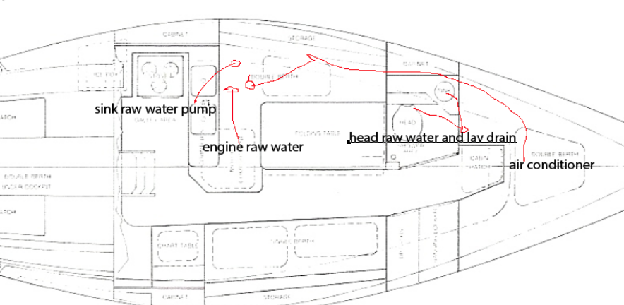

Plumbing question.
Kitchen sink is draining into the bilge. Is there another arrangement to allow the kitchen sink to drain overboard?
Someone add a air conditioner and used the kitchen sink overboard drain for the raw water cooling.

That anyone would want the sink to drain into the bilge astonishes me. Did Catalina design that?
Install a thruhull and drain it overboard.

No, Someone add an air conditioner and used the kitchen sink overboard drain for the raw water cooling for the air conditioner.
I know that Frank Butler would design it like that..
Sep 25, 2008
7,695
Alden 50 Sarasota, Florida
No, Someone add an air conditioner and used the kitchen sink overboard drain for the raw water cooling on the air conditioner.
Not a good idea. And the manufacturer installed a thruhull for the sink to drain the sink, not an aftermarket a/C. So now you have no sink drain. Since it would be dangerous to combine them, install a new thruhull and problem solved!

Don,
That would be best practices.
Or run a line forward to the lav sink through hull if it has enough fall for now until the next haul out.

I agree with Don, you need to install a new thru hull for the sink drain. I'm not sure if the sink will drain properly thru a line running to the head sink drain. I don't think you run a hose that distance and level enough to allow it to drain.
What's more important, a properly draining sink or the AC? If you can do without the AC for a bit, maybe go back to using that thru hull for the sink drain until you can install a new thru hull.

Or just drain it into the black water holding tank for now.
@Peggie Hall HeadMistress
I tagged the forum's sanitation system expert for an opinion as I'm pretty sure this would be a no no. Nasty bugs could migrate up the sink drain and into the sink, contaminating everything put into the sink. This is based on warnings to never connect a head to your pressurized fresh water system unless the head is specifically built for fresh water flushing. Nasties could migrate into your fresh water system otherwise.

Paranoia mostly. It’s a “what could go wrong” mentality. If someone plumbed an A/C circulating pump to a thruhull common with a sink (or any other open drain ) and forgot to open the thruhull valve or it gets clogged, the A/c pump backflows into the boat which, if left unattended while the A/C is running, could ruin your day.

No, I would never advocate putting the sink drain into the cooling water A/C drain or the bilge. It needs a dedicated thru-hull.
