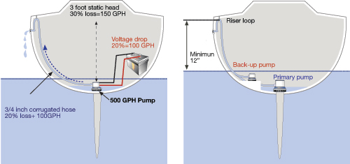

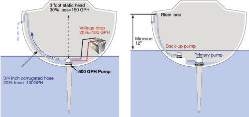

p.s. In you drawings above - in my boat - put the bulge pump at the bottom of that keel. Not at the top.
