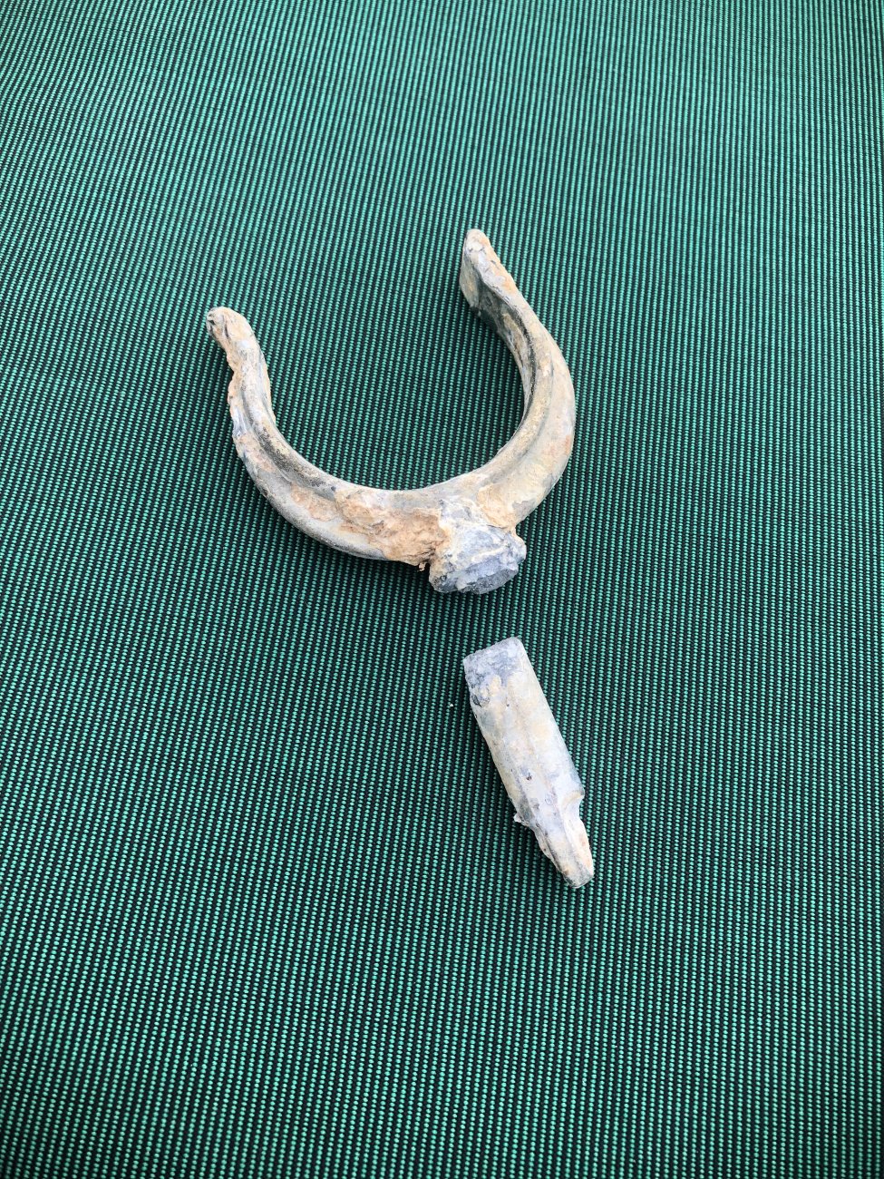

While rowing ashore this morning, between showers and while the wind was still piping up, about half way across to the Club (maybe 200 meters or so), and while it was about all I could do to make way against the wind and seas, suddenly this happened:
At first I thought the oat had popped out of the top of the oarlock, but then I saw the oarlock laying on the bottom of the boat. When I reached to pick it back up, grateful that it went in the boat rather than overboard, I realized it was in two pieces! Never had that happen before in 65 years of boating.
So, now I had one or in an oarlock, and still had the wind howling and waves pushing me farther away from the docks.my only real option was to tuck one oar under my arm, and paddle single handed with it while I rowed with the good oar in my other hand. I wasn’t able to make headway against the wind, and now rain, but I wasn’t losing any either, as I angled toward shore and a sandy patch of beach past the rocks. I beached and waited a few minutes for the rain to pass and winds to slacken a little, then shoved off and was able to make way upwind to the docks, about another 150 meters.
There don’t seem to be any of these on the island. I really want to replace them anyway with the type that are permanently fastened to the oar. Not a fan of these open oarlocks.

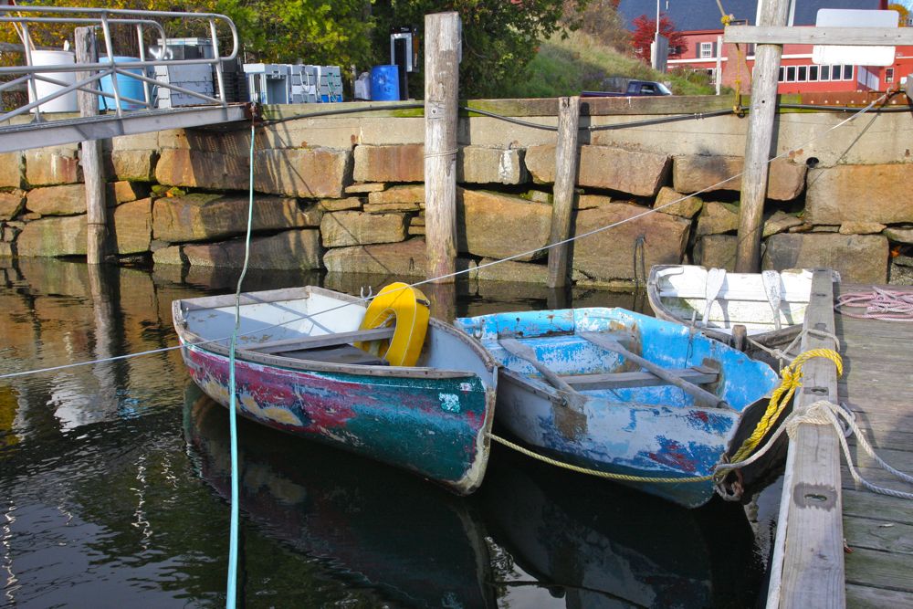

I hope your bailer is a 2000gpm pump, if that's your dinghy, Tom.
-Will (Dragonfly)
Haha! No, I'm a voyeur of fishing dinghy's.

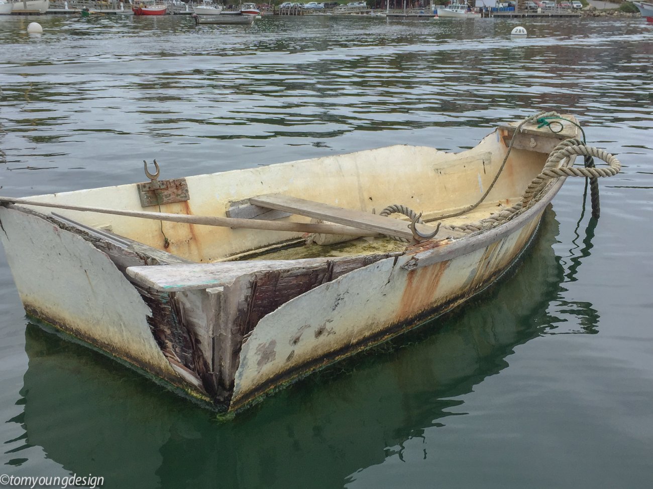

I see my tender as a lifeboat and a simple dinghy. As well as a spare oarlock, the lashed bailer(gallon jug cut open), the oars are always lashed inside along with 2 PFD's.
Boats do sink like a rock (as I found out once). Our tender is always in tow, I'm ready to step into it, anytime. :)

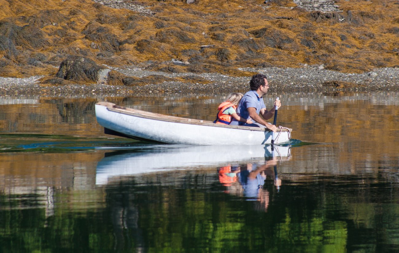

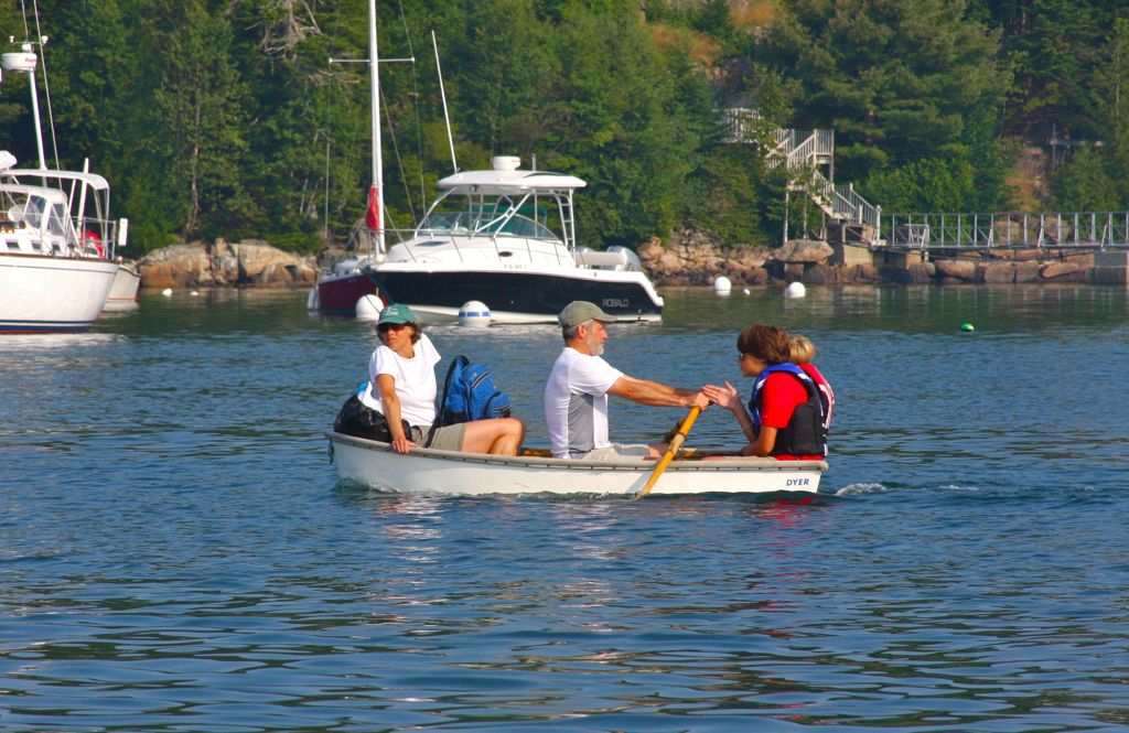

Size is everything in tenders. Except for prams or blunt bowed tenders like the Dyer's, the pointed bow of an 8' boat is not very stable. Ok in calm water with a tiny crew,...

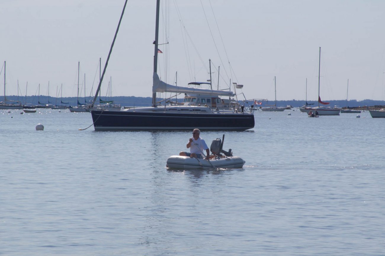

Inflatables are more forgiving of length to stability rowing from the bow, if you have the time...:
