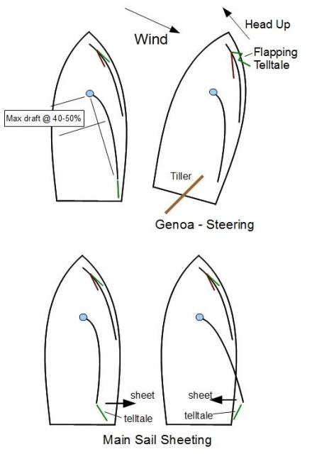

I use: three sets of telltales on the Genny*. Two sets down low like the first link above and one set up high. My lowers are where I can see them, just below the boom line. I don't use a middle set on the Genoa, some do. I don't use the middle set partly to keep it simple, and partly because I have a light boat on a gusty lake and I like to stay on the windward side as much as possible. One tale set up high makes for a faster twist adjustment - also I am not sure how I would screw up a middle telltale on the Genoa if top and bottom were correct.
On the main: three leech telltales as my previous post. Plus one mid-chord telltale, placed in line with the lower leech tale - as it appears at 10-15 degrees of heel. This telltale should be positioned just aft of where the Genoa leech shadows the main sail. If I remember - this should be about a foot back of that shadow - some modification for boat size - I think I am about 9" back. Now that I have a backstay adjuster I will add mainsail mid chord tales at the height of the other leech tales.
The mid chord lower main telltale is for setting the outhaul. Let's see if I understood Don Guilette and RichH: Trim everything else, ease outhaul until lee midchord telltale flaps, tighten until it flows.
Leech main sail telltales tell you about sheeting angle and twist. I have a short traveller, so I vang sheet. Boats with longer travellers can use that to sheet out (change angle of attack of the sail) and mainsheet plus vang to control twist.
