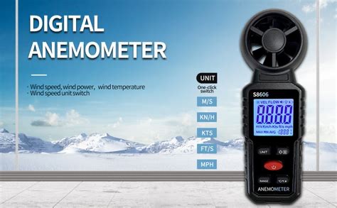

When I am comparing tools like the Wind transducer, I find a separate tool helpful in the process of calibration.
Something like this is helpful
Cost around $13 USD.
You must account for the variance in wind speed at 10 meters versus the surface, but this can get you close for calibration purposes.
