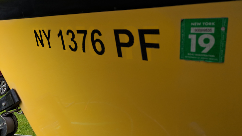

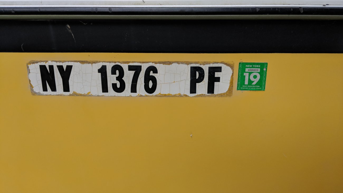

I decided that the registration numbers on my MacGregor 25 looked pretty bad so I ordered new vinyl lettering. It took a lot of effort to get the old numbers as well as the white backing off and to my surprise, I had three gelcoat shades. The oxidized general hull shade, a brighter shade under the white background and an even lighter shade under where the black numbers were.

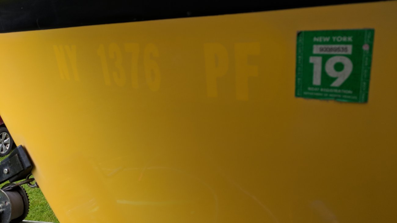

The only rubbing compound that my local marina had in stock was Meguiar's M49 and I applied that with a power buffer and wool bonnet pretty aggressively. The result was a nice shiny hull in general with the old registration numbers even brighter. (see pictures)
My question is if you think that a better (more aggressive) rubbing compound like 3M Marine Rubbing compound 09004 would do better. I'll have to drive a fair distance to get it in stock. I did order 3M Marine Compound and Finishing Material 06044 from Amazon since I could get it in 2 days. Should I make the trip to get the 3M rubbing compound or another suggested compound?

Is your goal to buff the entire hull to the color that was under the letters? That will be a big job, if it’s even possible. The gel coat on the Mac25 was not that thick to start with.
14,190
Time and Sun are your friends. Gelcoat oxidizes and changes color with UV exposure. Some colors are worse than others.
You might try some 1000 grit wet sandpaper, but I wouldn't be too aggessive or you might go through the gelcoat. Replicating the original design, i.e., putting the numbers on a vinyl background to hide the old numbers.

I second what Jackdaw and Jon said. You’d have to bring all the surrounding gelcoat to the recently exposed color, lot of buffing!
It will most likely fade as the newly exposed areas sit in the sun; might take a little bit, the old number marks on my boat needed one season to vanish (and were mostly covered by the new numbers anyhow).

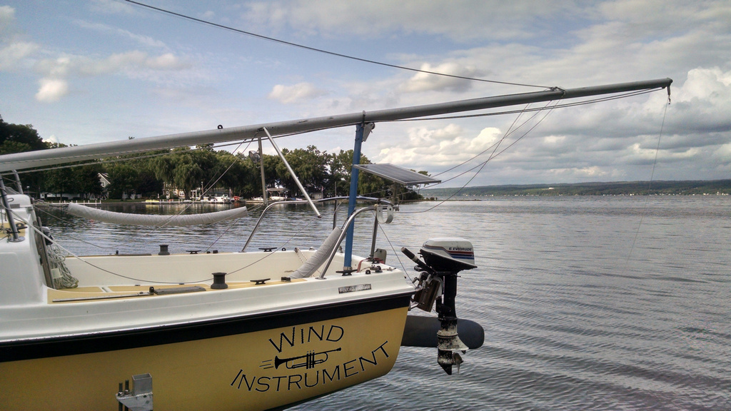

Thanks for your replies. It sounds like it is pretty unrealistic to try to take the amount of gelcoat off that would be required for the old lettering to not be visible. I guess it is a lot smarter to just put the new lettering on and wait for the old lettering to fade away. I think it will look something like the picture, although I am not that great with graphics programs.

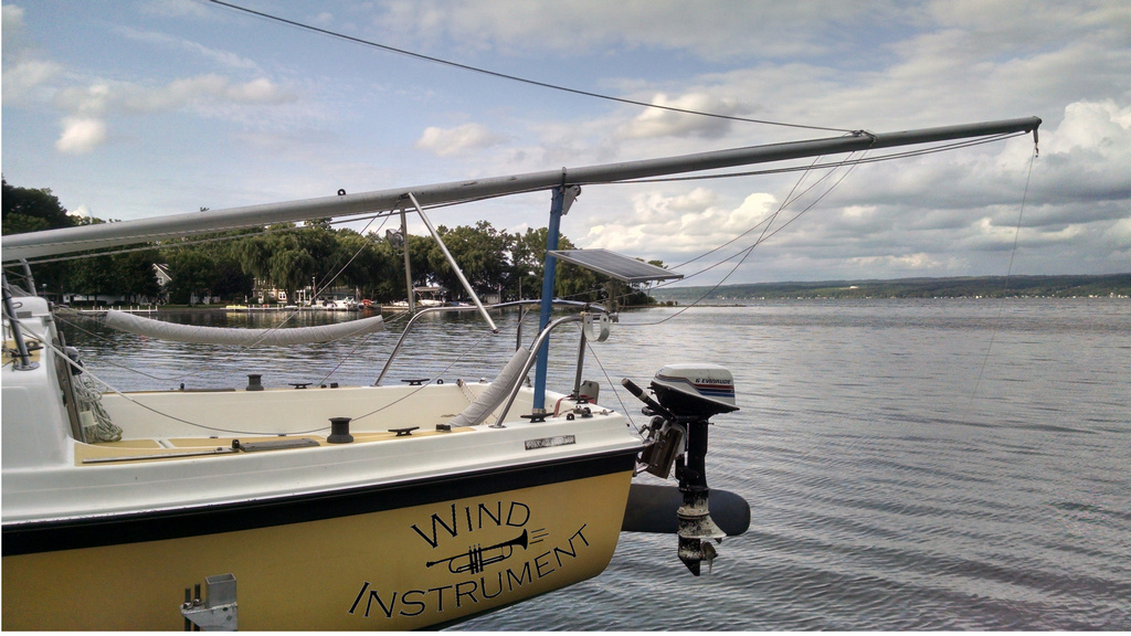

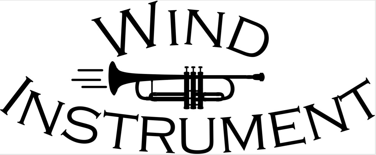

Thank you all for your helpful suggestions. I will definitely remember the heat gun and lighter fluid removal method and to use toluene-based brush cleaner to remove wax before the application. The thing that I am most concerned about now is that I have two large boat name vinyl graphics to apply to both sides of the boat. I'm sure glad that none of the previous owners did what I am about to do because my boat name probably falls in the "truly stupid name" category for anyone but a trumpet player. The actual 16x39" graphic along with what I hope it will look like on the boat are attached as images. I ordered one graphic with the trumpet facing forward and the other with it facing backward. Otherwise, the boat would tend to rotate in tight little circles :). But, I haven't decided if the trumpet on either side should blow forward or aft. Any opinions?

Wow, it is not often that I disagree with those that know more than me, but I would place the trumpets blasting forward - announcing your arrival!

I like the name and the trumpet! Trumpet facing aft......for those few times when there is no other wind. Regarding the registration numbers: If they were the "stick-on" style just get a sheet of those in a contrasting color from the hull color and stick them where the other numbers were. OR....you could offset them a bit and employ the shadow to your advantage.
