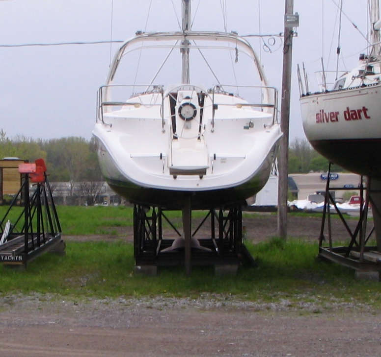

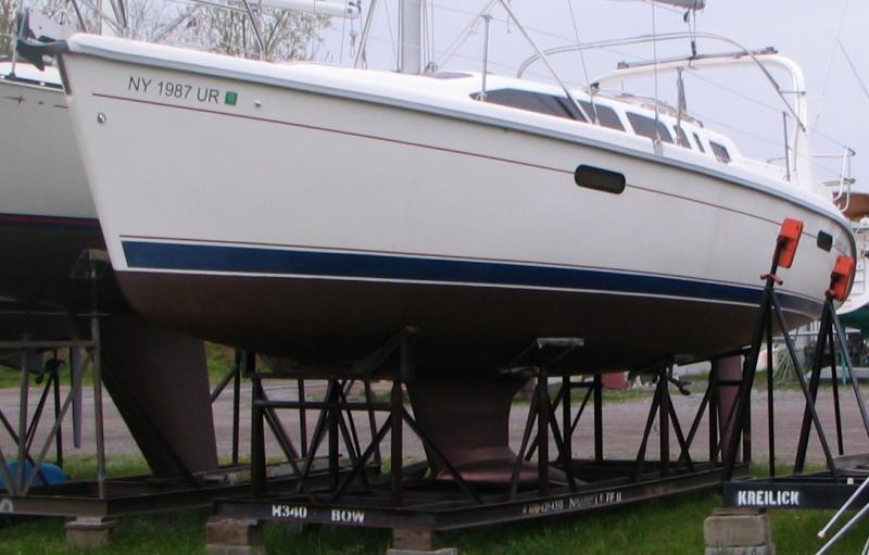

My H340 wing keel version (4-1/2 ft draft) had 600 lb more ballast than the fin keel version (6 ft draft). That big bulb of a wing was needed to compensate for the reduced keel depth. Made the boat 600 lb heavier, of course.

T,,, I have seen this is true. That the wings are heavier. How does that effect the sailing?
Slower? Deeper water line? Obvious is trailer weight but once in the water?
Since I haven't sailed both versions of the same boat, I couldn't say for certain, but with an extra 600 lb of lead hanging under there, I would think it would sit a little lower. I always thought it should point a little tighter to the wind, but I never raced it, and didn't really care that much. Better sails might make a noticeable difference. So would a better skipper. :dance:
Oh, and no trailering that boat, at 11,000 lb bone dry. One of the big reasons I sold it and got this trailer boat.
By the way, that 272 is a sharp looking boat. :)

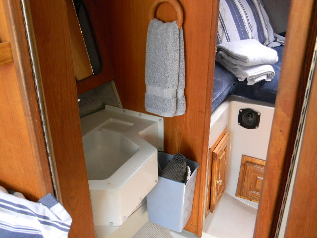

modifications to hulls interior
In the attached picture there have been two doors cut into the interior parts of the hull of the O'Day 272LE. I can't imagine there is much storage behind these two doors. Other than not liking the looks of the oak kitchen cabinet door style - is there any reason to be concerned about this modification?
Access panels for something, maybe?
My boat had a little kitchen-cabinet style door in the cabin when I got it, and I replaced it with one of these: http://shop.sailboatowners.com/prod.php?17267 Purely aesthetic, of course, but it looks more like it belongs there.
