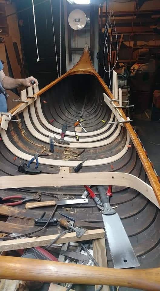

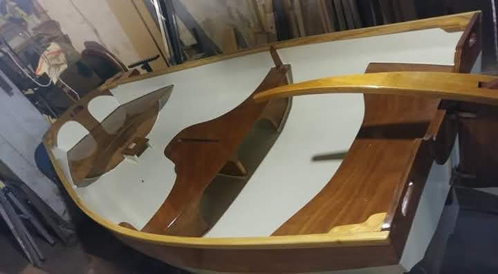

I am (was) a wooden boat builder restorer, fiberglass and epoxy is bad enough on the outside bottom don't make a bad situation worse by trying to do the inside with epoxy it doesn't save anything and locks in any moisture and rot that's already there. Pictures would be nice I can be found on wooden boat forums also DeniseO30
CLC Eastport plywood pram designed for epoxy coating and they only recommend cloth on the bottom outside.
Red and white cedar are both very easy to steam bend white being the choice almost always.
Red Cedar splits very very easy even when drilled.

Have built several cedar-strip boats with fiberglass/epoxy layers both inside and out, but they were designed to be built that way. Water is carefully kept out of the encapsulated wood. A wooden Lightning is not designed that way. The pieces it is made of are held together with fasteners that penetrate the wood and allow them to move, which means water WILL get in. This WILL lead to delamination and rot, especially if it is channelled between two impervious layers of plastic. Leaving one side "open" from encapsulation, as in the pram above, allows the moisture an escape route, so is better than trapping it in with a coating of epoxy on the insides. As dlochner suggests, the pressure-treated stuff will have to be removed. It is too heavy, ugly, and wrong. The epoxy/glass outside layer may adhere well enough to work for a good while. (Epoxy is better than Polyester resin at staying stuck to wood.) It likely adds quite a bit of weight to the boat, however, so don't expect to win lots of races. Photos? Good luck!

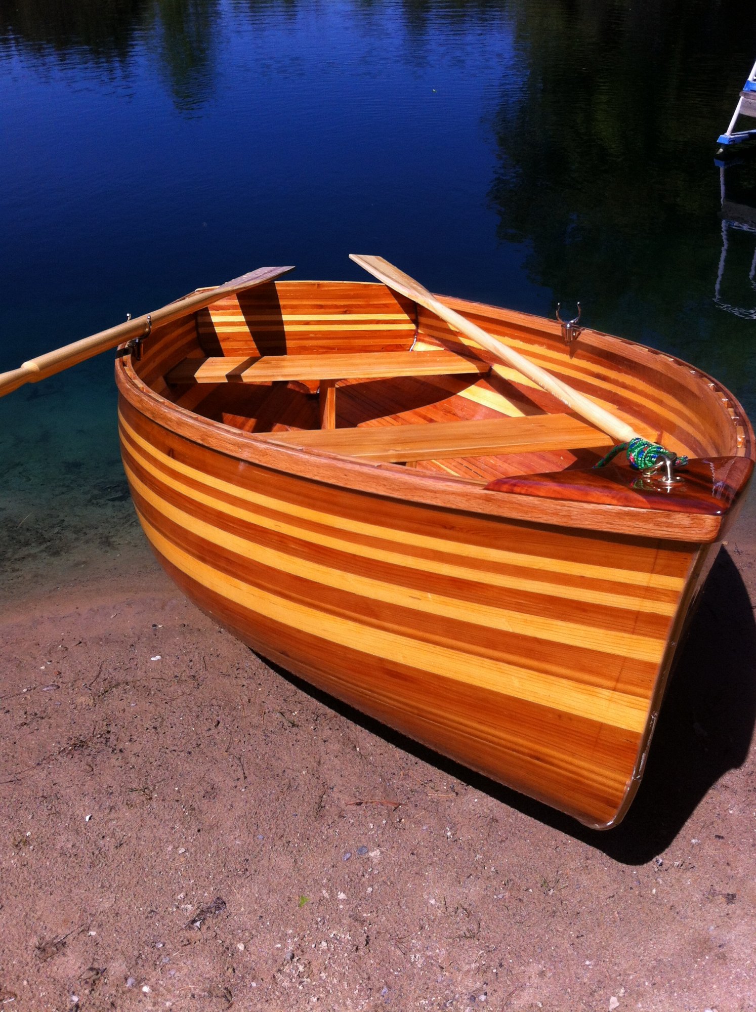

My first impression was to restore it in the same manner a cedar strip dinghy would be built ( I built one 10 years ago.)
I see Now I was heading for disaster .

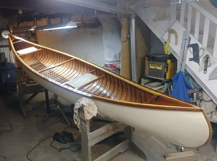

We, now just me, built about seven or eight strip canoes a couple plywood kayaks, restored a number of Old Town canoes got real tired of sticky stuff and I said "no more sticky stuff" I went with traditional boat building, then before I sold my house somebody gave me the CLC pram that they couldn't quite finish so it was back to playing with the sticky stuff again.
