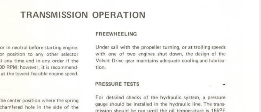

I put my transmission in reverse. It adds some drag (about .5 knots) but is better for me than burning up the transmission. Best recommendation is to follow the transmission recommendation.
Checking my Borg-Warner V-Drive manual I see this information.
The manufacture says it is ok. When surfing down the face of a wave at hull speed. I do not like the whine made by the speeding prop. Stopping the whine makes me feel better.
