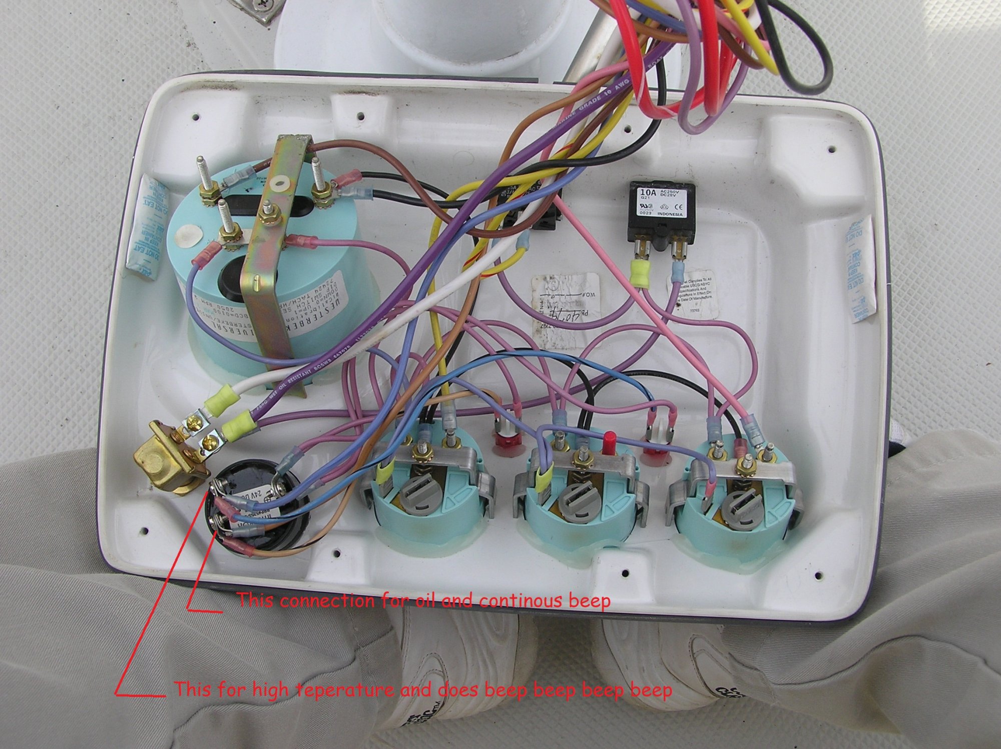

Is there any other place other than CD where I can purchase the oil pressure/high temperature alarm? Mine is starting to sound pretty sick. They want $28 btw.
Nov 18, 2010
2,441
Catalina 310 Hingham, MA
Are you talking about the piezeo buzzer? You can get them on Amazon. But typically a poor signal sound is caused by a bad ground. Do you still have all the grounds stacked on a lug on the engine near the head wall?
If so, consider adding a negative buss bar at the engine and cleaning up the connections. Don't forget the dielectric grease.

Thanks Jesse, I've noticed that the connectors do have an impact on the volume of the alarm.
Mine ran for 8 hours straight earlier in the season due to faulty oil pressure switch and thought this might have ruined its vocal chords...

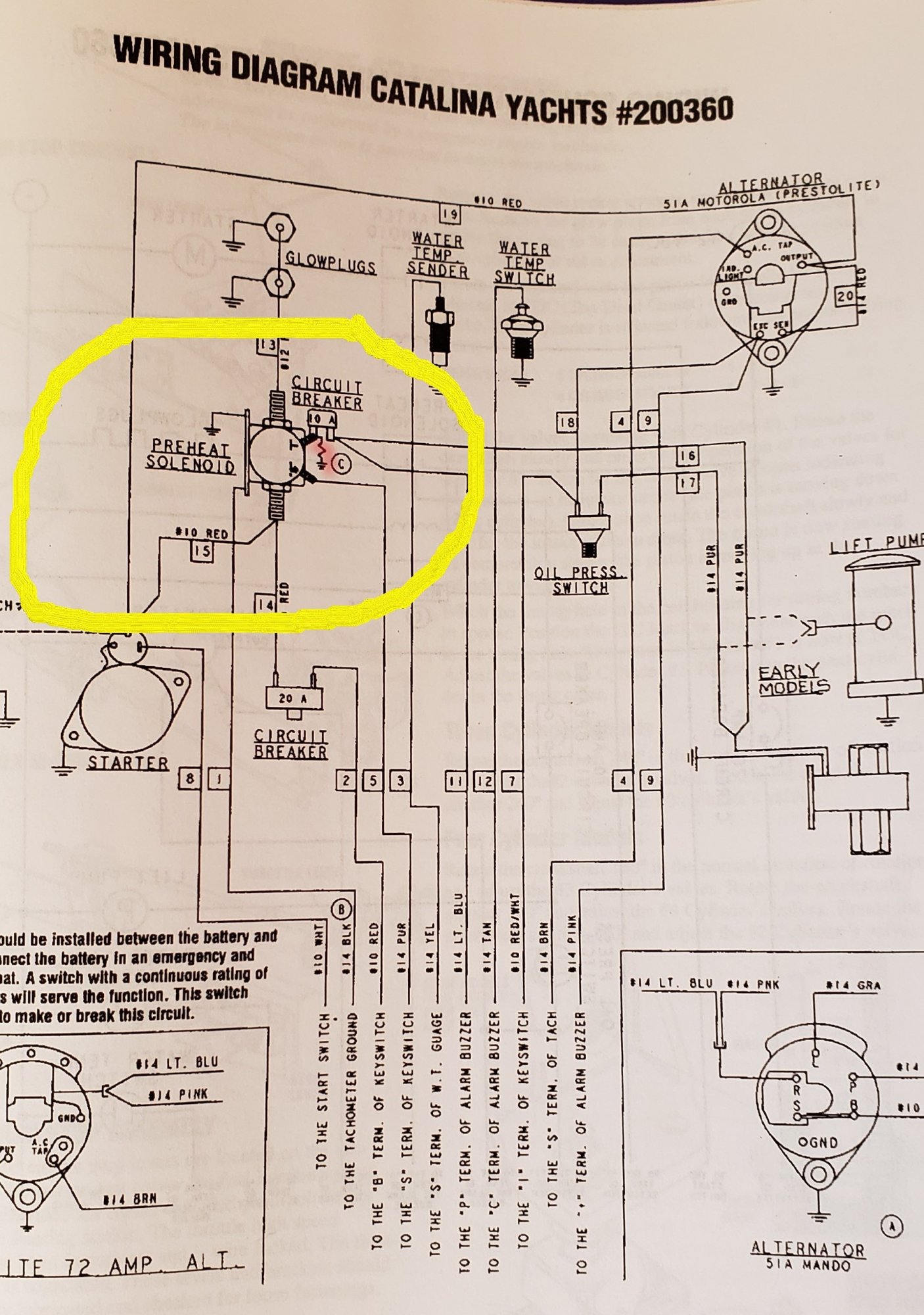

On my C36 it is 24 V. I guess because it is in series with the fuel pump coil. I am not sure how your circuit is. Check the electrical diagram and check the soanalert itself. You can also read the voltage while it is producing sound. Yours may need 12V instead.

I just replaced the alarm with one from Catalina Direct.
This has two sounds in one horn. Beep continuous and a beep chirping sound.

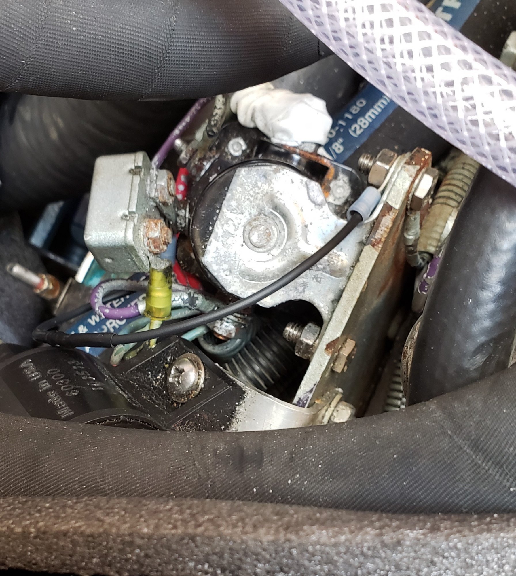

On the Catalina 310 you can rest the solenoid without removing it. But you need two people or alligator clip ends for your multimeter.
Take the multimeter and ground the back to the engine or a known ground. Then touch the starboard side terminal on the solonoid with your positive lead from the MM. This should read close to the battery voltage. Now touch the positive lead to the port side terminal on the solonoid. This should read zero or close to it. Now have someone turn the engine key all the way forward, it should now read close to battery voltage.
