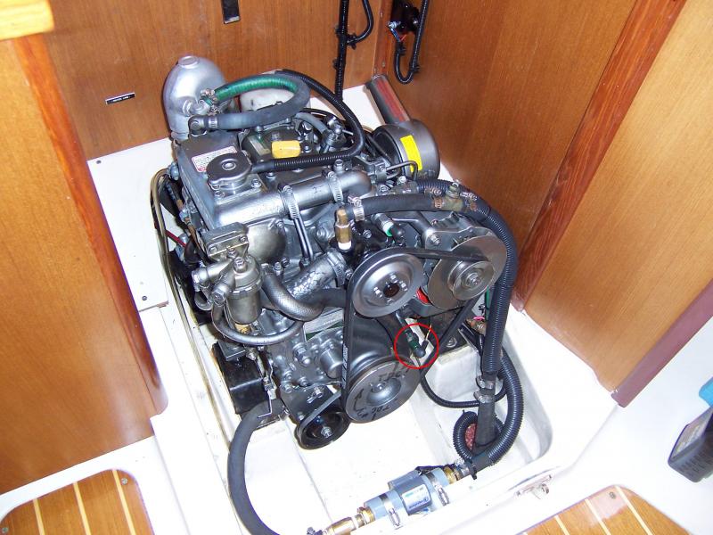

The alarm that rings after the key is switched on but before the engine starts sounds only sometimes. I believe that I am experiencing intermittent contact on the Engine Oil Low Pressure Indicator on my Yanmar.
Questions:
Where is the sensor located on the engine?
What is the sensor part number?
Is there a pdf of the detailed service manual online?

Assuming it's a 2GM20F ..........................
......................... that's it in the red circle down by the oil filter.
Sorry I don't have a part number but any Yanmar dealer will be able to identify it.
