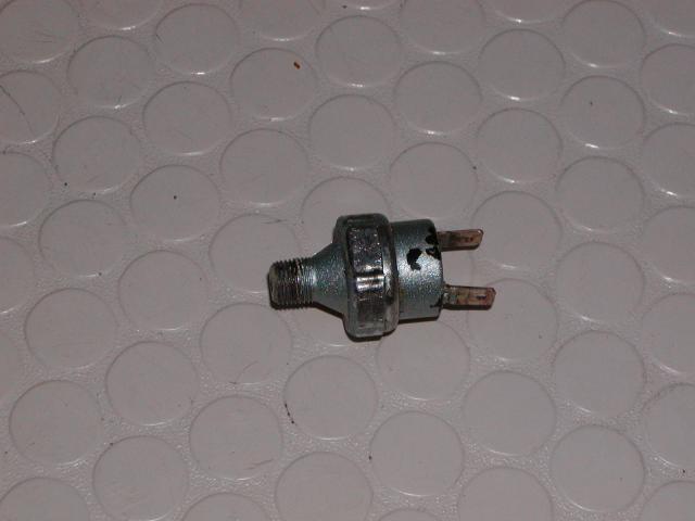

Ok, so I went to the Torreson Marine website and found this doo-hicky (see photo) it's called an "Oil Pressure Switch - Single prong". Is this what you would refer to an oil pressure sensor or pressure transducer?

danny ...i am not Rich but yes that is the oil switch/transducer in the pic and yes you can go to an auto parts store and find a oil p guage ...if you want to keep both just get a pipe tee the size you need and install both ...hopes this helps...

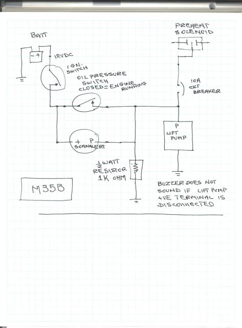

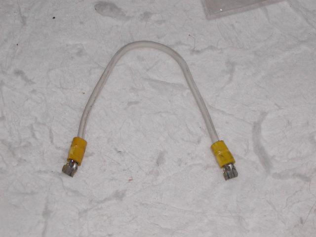

oil pressure switch - see the photos. The pressure switch is normally open contact- when there is no pressure. When the oil pressure developes the contacts close and places a short across the buzzer so it can not make any noise. To confirm if the switch is causing a problem - disconnect the two wires from it and jumper it with a short jumper - like the one I have made. Then turn on the engine and see if it works OK. If so then replace the oil pressure switch. If no then replace the 1 K Ohm resistor - see the wiring diagram. The resistor is inside a shrinkable tubing and is next to the fuel lift pump. It is not easy to find. The part number for the oil press switch is 037323. On my engine it started to leak and I lost most of the engine oil. The galley floor was a mess. Good luck. Contact me if I can help baysailor2000@att.net

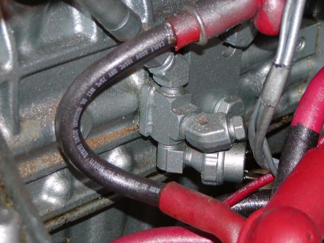

So I got the new oil pressure switch and went up to the boat to change it out but found that it is buried in one of the most inaccessible spots on my boat. I needed a mirror just to see it. I didn't have a socket large enough to get it removed so at this point, I haven't gotten much farther on my project. I did get the wire off and cleaned the lug but the light still came on, wishful thinking that that would help. Anyway, after reading through this and other threads regarding oil pressure sensors, I've seen a lot about a warning buzzer. I have not heard a buzzer nor do I know if I have one. Would that be located on the engine control panel?
