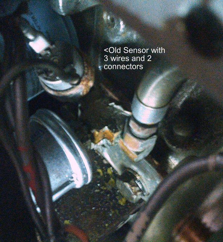

Ok first round of troubleshooting: I went down to change sending unit and the one I purchased from Universal only had one terminal on it (pic2). The one on the boat had 2 terminals with 3 wires going to it (pic1).
1 wire appeared to be a standard oil pressure sensor wire (14 gauge?) to activate the light/buzzer. The other terminal had 2 heavier wires (10 or 12 gauge?). The 2 heavier wire set up appeared to be hot... it hit the block and sparked.
I put a manual oil pressure gauge on it started motor and the light came on..but good pressure on the gauge 35+lbs. This would indicate to me it is a bad sensor.

Where can I find the proper sending unit?
What are the 2 heavy gauge hot wires going to sensor?
I found a wiring schematic from the previous owner and it looked like the diagram pointed to the wires going to the lift pump...WHY?
I looked at another 1994 Catalina 30 and his setup was identical so I know it is not a aftermarket add on.
