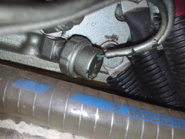

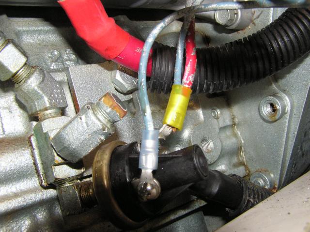

Could one of the Universal XPB experts perhaps help me out of a very frustrating phase.
Recently one of the prongs of my Oil Pressure Switch broke off and set the alarm off. After chasing all over Sydney to find a similar replacement, I find now (after also discovering that I could have bought an original unit from Torresen’s in the US at about half the price, including freight) I cannot silence the alarm:
New Oil Pressure Switch
Prong 1(P1)
(closed circuit)
Prong 2 (P2)
(open circuit)
Prong 3(P3)
Scenario A:
Existing 2 wires connected to P1 and P3 respectively (circuit open).
Result: 1.When switching the ignition on, the alarm sounds.
2. When starting + running engine, alarm continues to sound.
Checks: At stage 1. the circuit is still open with the wires showing 12V and about 8V
respectively.
At stage 2. the wires show about 13V each, with the readings fluctuating due to
shaky ground connection whilst engine running. This would mean that the oil
switch has closed, oil pressure is ok and that current is flowing to the fuel lift pump.
So, why is the alarm still sounding and the oil warning light showing? I thought
that when the lift receives full current, the alarm cancels. (Can’t hear over engine
noise whether the fuel pump is running)
Scenario B:
Existing 2 wires connected to P1 and P2 respectively (closed circuit).
Result: 1.When switching ignition on, no alarm. But the fuel pump is ticking over.
2. When starting + running engine, alarm sounds.
At stage 1. the wires show about 12V each. Did not check at stage 2.because it was a closed circuit.
Obviously, the fuel pump received enough current to cancel the alarm. So, why would the alarm and oil light start when the engine is running? It could not have been caused by lack of oil pressure, as the switch has effectively been by-passed.
What am I missing? The problem seems to be caused by something other than the oil switch. Have trolled the forums, but have not seen anything that might explain this. Any comments would be very much appreciated.
