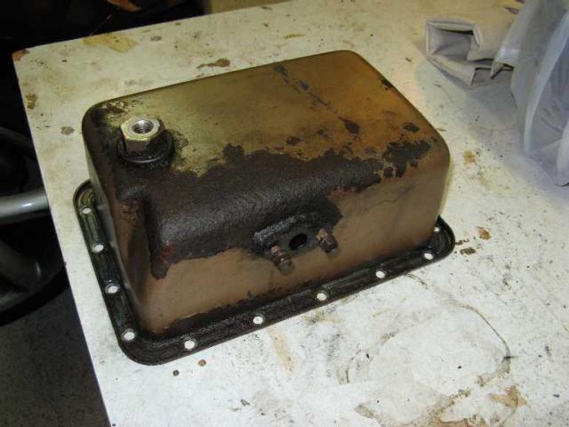

What engine do you have? I have a Universal M25 with the original oil pan (34 years old) that is in fine shape. There was some rust from a leaking Sherwood raw water pump - this is almost always why the oil pan rusts, keep an eye on the pump (especially when the engine is running). I jacked up the engine cleaned the rust, used rust converter and repainted it. I'm sure the the pan will last as long as the engine does - the metal is very thick. Here's a picture of a typically rusted pan (worse than mine) - this pan could be easily restored. Unless your pan is really bad, no need to replace it just touch up the rust.
