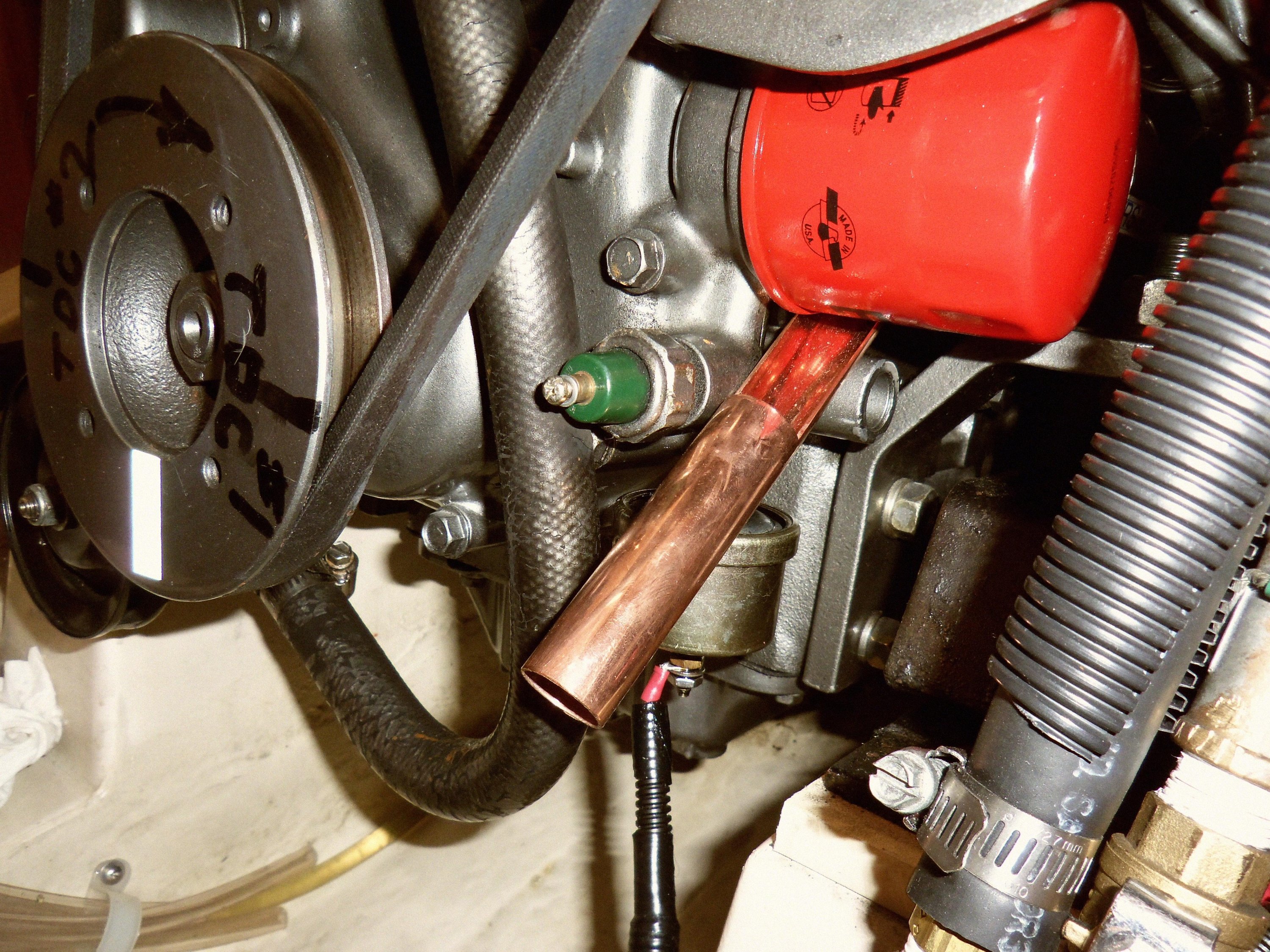

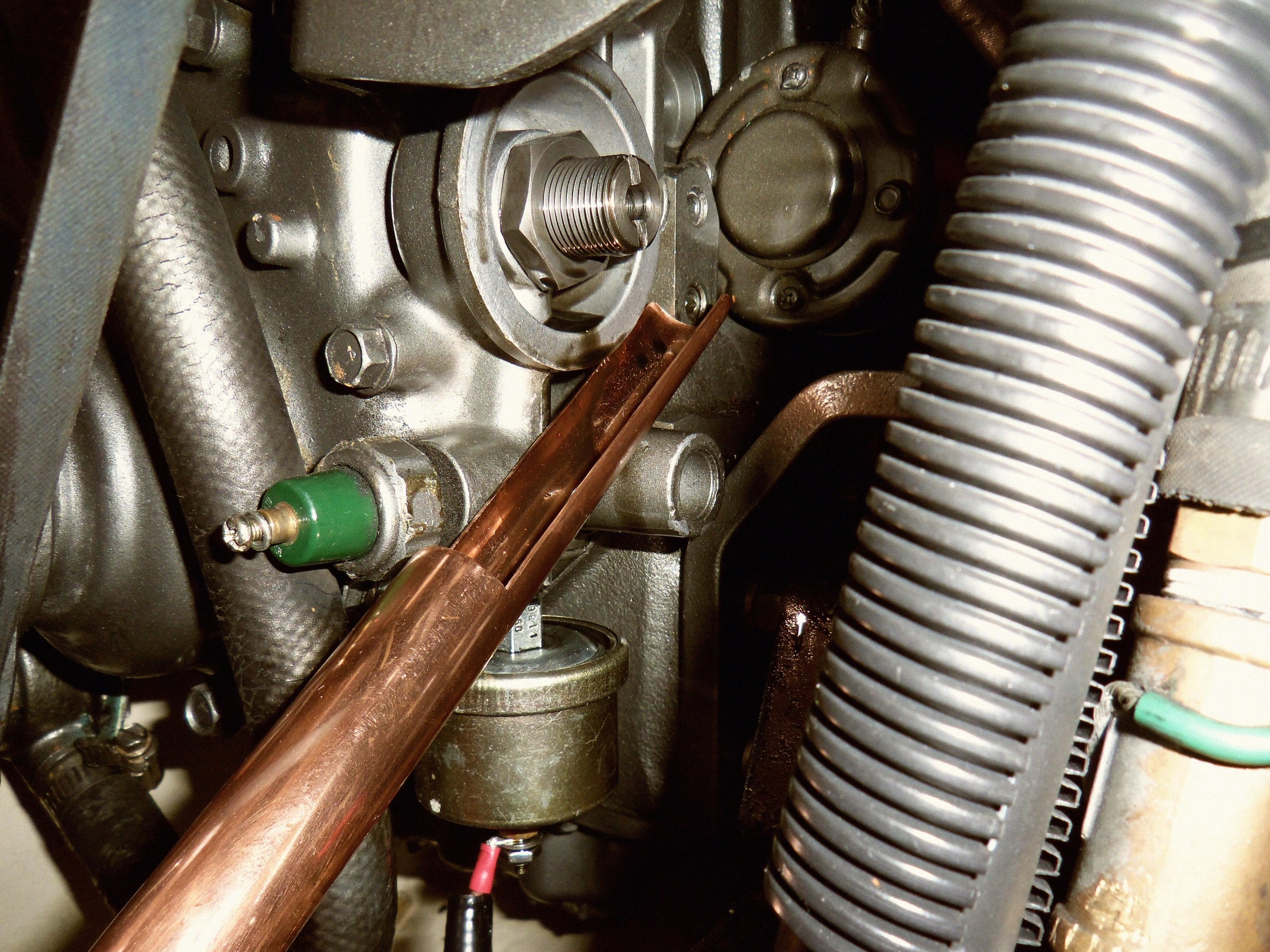

Jan 4, 2006
7,870
Filter location is shown as so:
The hi-tech little gizmo under the oil filter is used to avoid oil spills onto the block when the filter is first unscrewed. A strap type wrench fits nicely with all this room.
Note Stu's remark for instructions on installing every oil filter I've seen. The only way to go 1/4 turn past hand tight is to use a wrench so it's not coming off without a wrench.
The diameter of the Yanmar oil filter is 3".

Ralph, what is the diameter of the copper tubing? (Ingenious tool, BTW. I really admire you guys' creativity.)

very nicely done Ralph....I'm taking this one!

BTW, there has been endless discussions/debates about the value of using Yanmar filters. I think we do agree that Yanmar does not make its own filters, though the Yanmar branded filter may be made to Yanmar specs. Some have cut the little devils open to compare filtering elements and pressure relief springs. You might do a search to decide which to buy. Ralph's catchment tube is patent pending, or should be if it's not.
