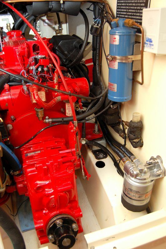

There are a few tricks..
1- Poke a hole in it with an awl and drain it into a can with an oil absorbing pad..
2- Wrap/surround the filter in a one gallon zip lock bag with an oil absorbing pad in the bag. Now carefully crack the filters gasket open and let it drain into the pad in the bag, works darn well.. Once drained remove bag and zip it closed.
3- Install a remote oil filter..:D
I chose the latter...
Big benefit here is more sq in of filter, I used a larger one than the engine had originally, and I added nearly a quart of capacity to the oil system. More surface are and more oil never hurts an engine...;)

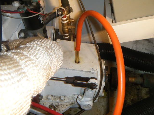

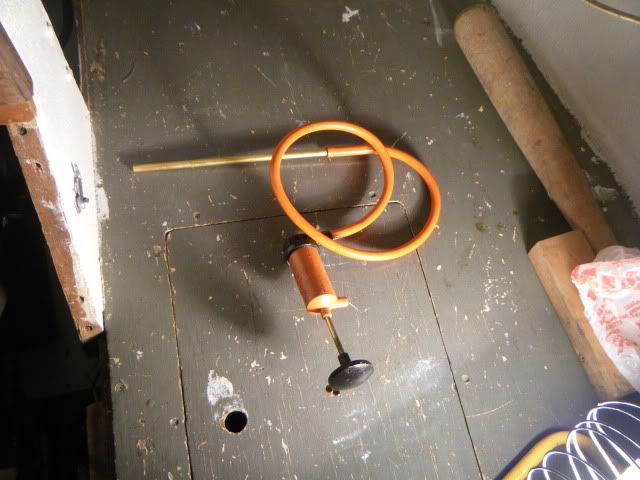

The little pump that could including right out of a dipstick
My motor is installed at a 15 degree incline SO a new hole to remove ALL the oil hass worked out well ;)

I'm with mainszil
A remote filter is next on the list. Even with poking a hole in the filter, I always manage to make a little mess at best, a major one at worst.

Transdapt filter relocation kits
I found transdapt remote filters on Amazon. For the Universal M-25, it matches with a 2004 chrysler sebring. (20mm x 1.5 thread size). I mounted it to the bulkead (similar to MS's location). Makes the filter change a breeze. Using that and the mytivac, I hook up the vacuum pump to a hose off the sump, pump it a few times...have a beer...when it gurgles, I loosen the filter, and then bag and remove it. Reinstall, re-fill, run motor, check the levels then go sailing!
