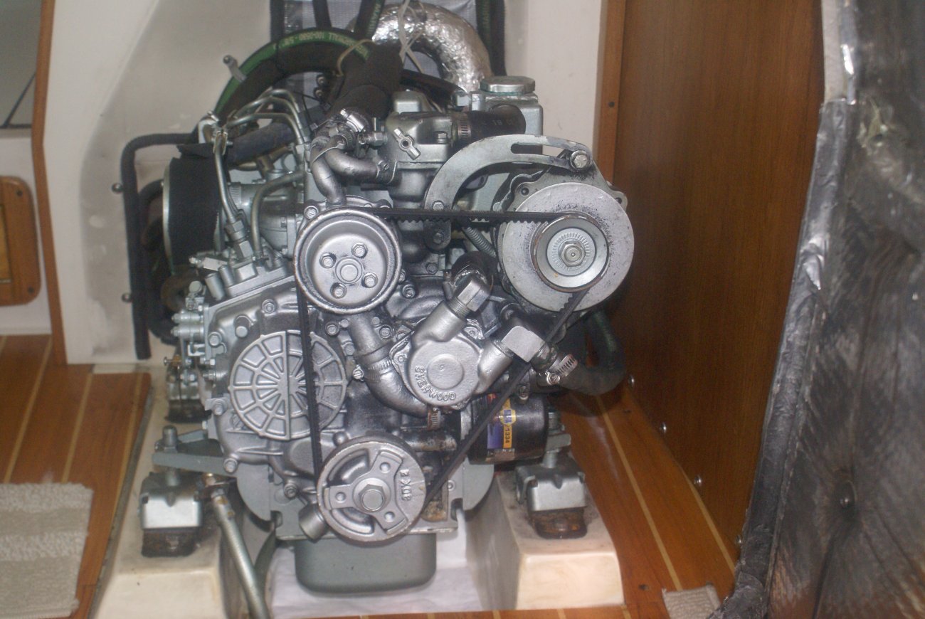

Assuming you have a Universal M-25, the oil filter is forward, low on the port side of the engine. My engine has a drain hose on the starboard side. I have an oil extraction pump. Open the the oil drain hose, insert the extraction pump hose, pump up a few times and the oil is sucked into the pump container. Unscrew the oil filter and put on the new one after lubricating the ring with a bit of oil. The oil fill is on the top of the engine, a bit starboard and forward of engine center. I use an oil extraction pump because I've not found a drain pan I can place under the engine, and then get it out without spilling the oil.
Picture: You can see the oil filter, lower right (NAPA filter). The oil drain hose is lower left. The oil fill cap is hidden by the anti-freeze hoses on the top of the engine.
