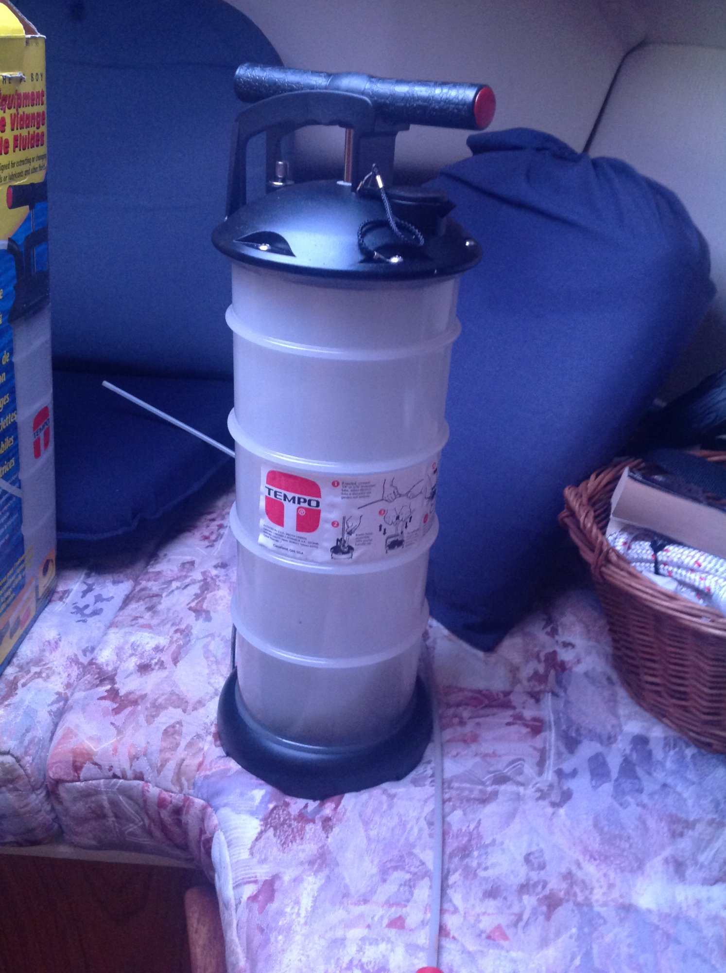

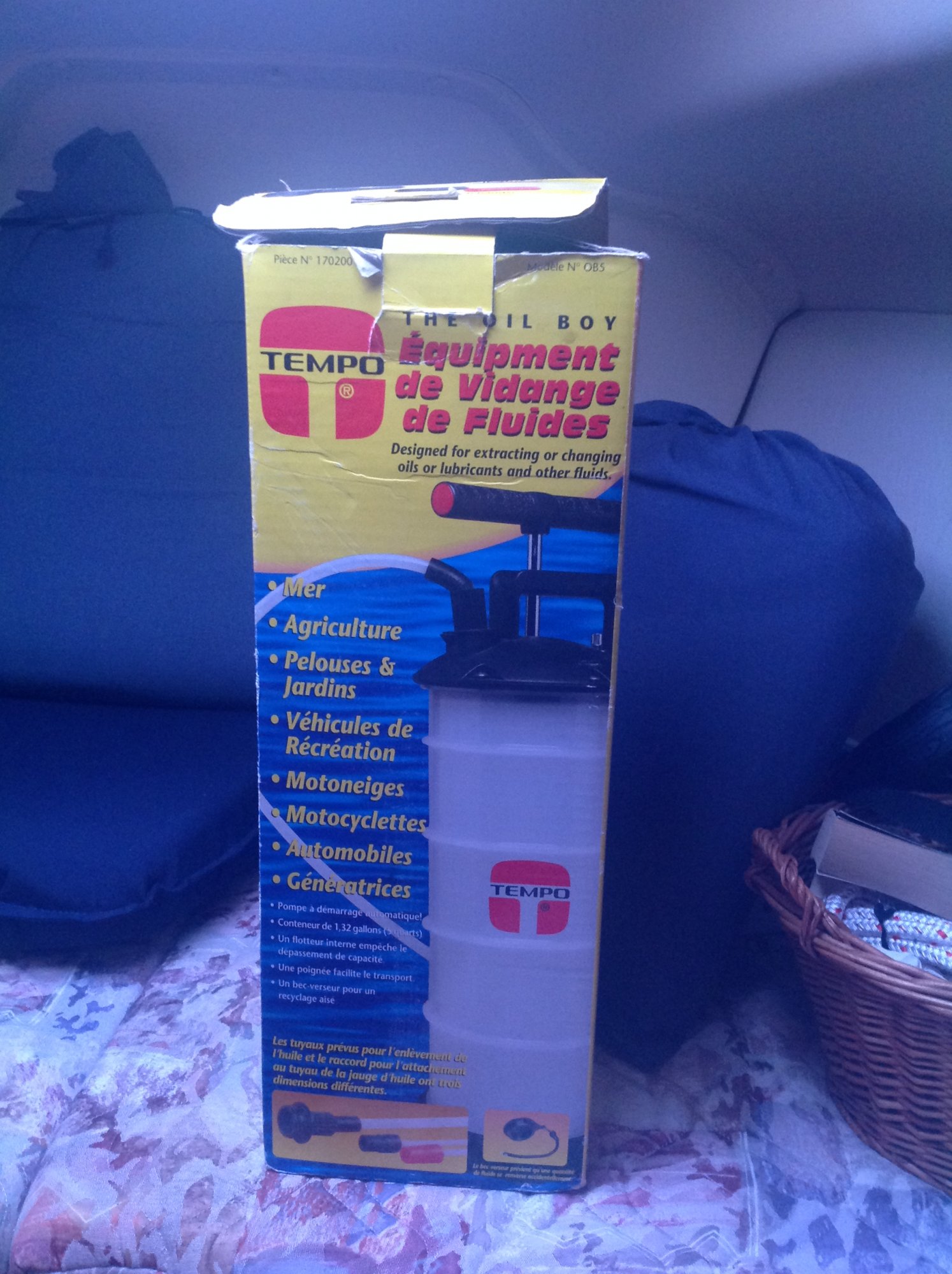

I was on my boat early this morning and remembered you asked for suggestions. They are all of the same design, but more importantly, they work.
I’ve had mine for 21 years and it continues on and on. Mine is aTempo Oil Boy. Like all the others it has multiple connections for different size tubes.
You won’t regret having one.
