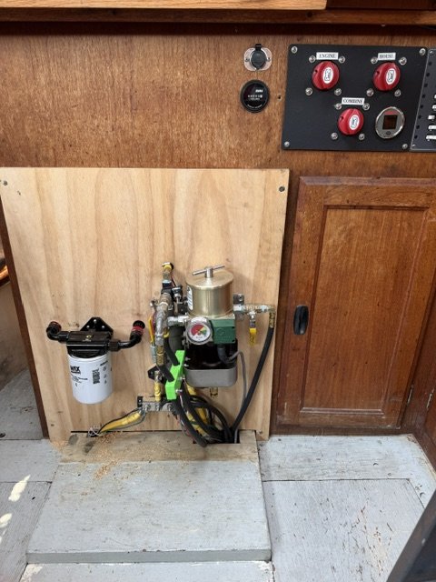

I knew that challenge. Only the filter on my Perkins was hung on the front of the engine in its own metal container. A 1973 design for this modified tractor engine. When you unscrewed the bolt on the bottom the container of oil flooded into the bilge. I used a plastic bag to try and catch it. The process was always messy.
With the engine rebuild I transferred the oil filter off the engine. Now it is easy to access and the spin off filter contains the oil.
