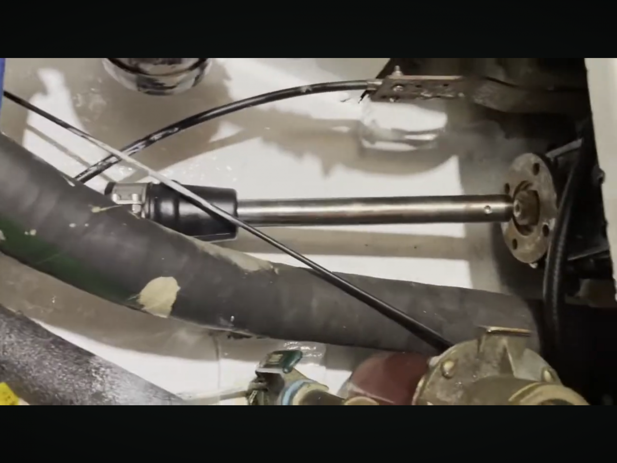

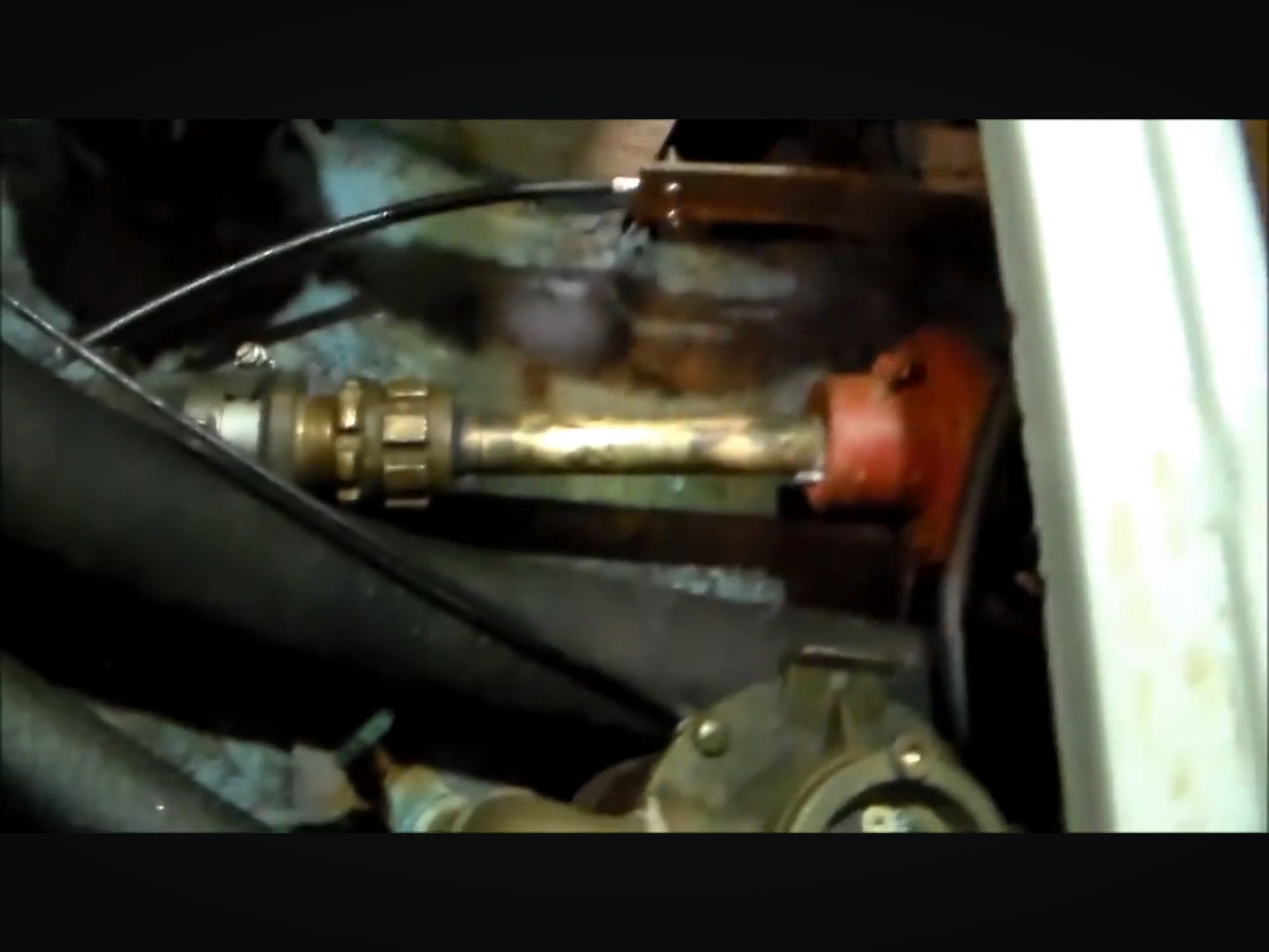

My engine bilge looked like crap when I bought Tally Ho. And the regular bilge was pretty dank and nasty, I do have a bilge pump, but it leaves some water in the bottom.
I scrubbed the engine bilge, and painted it….made a huge difference.
I also changed out the old stuffing box with a Volvo dripless shaft seal. Also made a big difference.

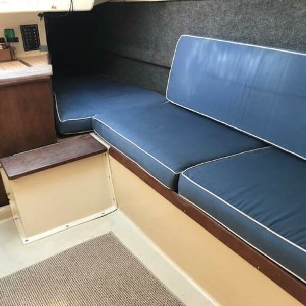

Project Mayhem , no I'm not referring to the fiberglass tube . On our 25 , 1981 ,there is a step on the port side about halfway between the countertop and the sole . It has a teak step that flips up . We usually use this as our garbage receptacle. The whole unit unscrews from the sole .
Oh that's a much different configuration! Does it look like this? Did you end up installing a fan or a pump in the aft end of the bilge?

That is exactly the same as ours . I removed the whole step assembly by simply taking the screws out . On the port side of the centerboard tube ,I very carefylly cut just enough of the sole to mount a horizontal bilge pump .
