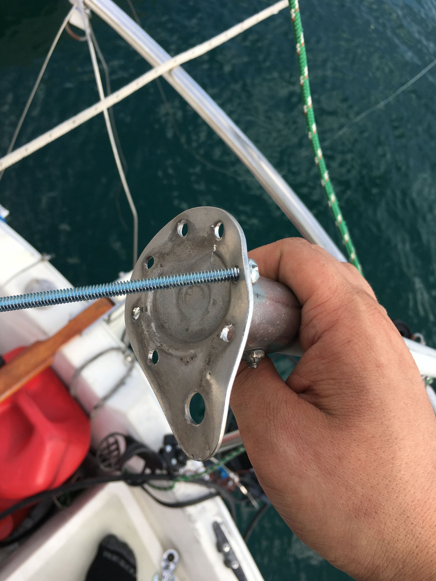

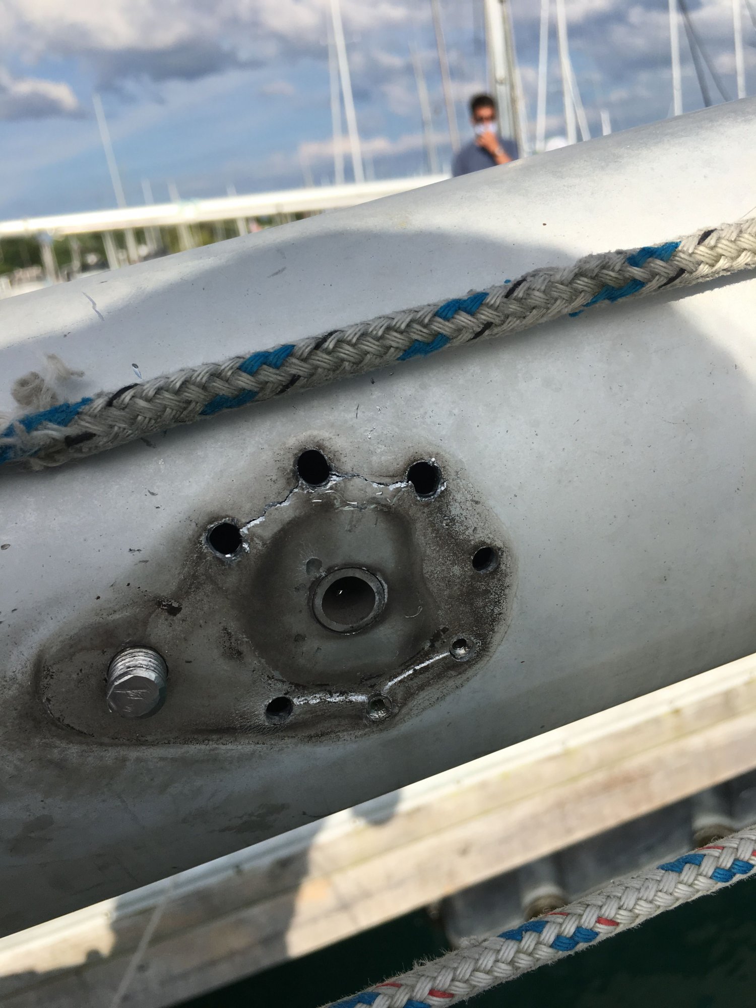

I'm convinced this boat is cursed but that's a topic for another day. One of the stays got caught when we were stepping the mast and ripped a spreader from the mast. I was originally going to throughbolt both spreaders with long screws but the first one snapped when I tightened it down so I tossed that idea aside. There are two other options that don't require welding. The first is to move one or both spreaders down a couple of inches. I think I have enough threads on the turnbuckles to do that. The other option is to fabricate a plate to "sleeve" the side of the mast that broke. Which would be the better option?
