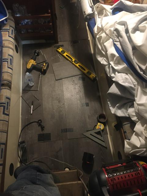

I'm installing some composite flooring that I found at the yard. I have some H channels that need to be semi secured to the cabin sole. I was thinking some sort of velcro so I can access the bilge if needed. H channels will help to hold the flooring in place

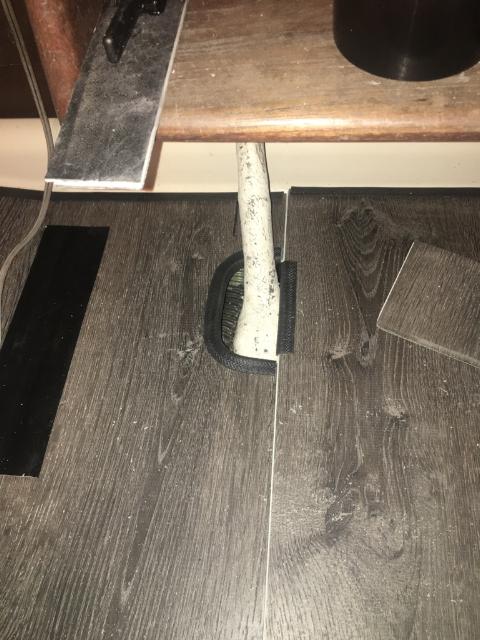

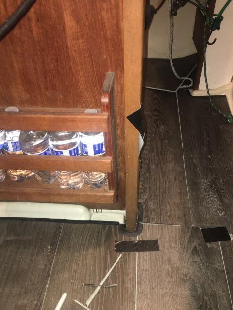

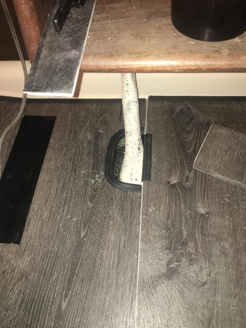

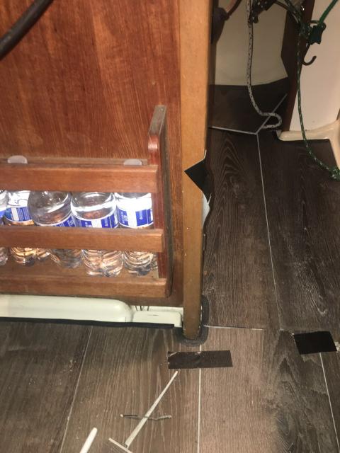

See attached. The flooring is broken up into three sections for easy removal. The H channels will be between the sections. I'll probably end up getting some J channels for the outer edges. The channels will need to be removable for bilge access and cleaning

The gorilla does look like a 3M knockoff. I'm actually using a lot of gorilla tape to hold the planks together. I'll add some epoxy at the edges when The project is nearly completed.
This flooring is made to snap together without any adhesives. The foam backing helps keep it from moving. I'm essentially emulating wood trim with the channels

For anyone else that's interested in installing similar flooring...
The sole of the cabin is rarely flat. In the corner of my boat it's a significant angle. I was able to make cuts 90% of the way through the flooring, apply some tape over the cut and then snap it by hand. This is essentially scoring and breaking. What's left holding the plank together after breaking is a thin layer of vinyl and adhesive. If these thin layers are bent back and forth enough, a line will form. The tape helps keep it from over bending and flopping back and forth. The foam backing on the flooring stretches a bit which allows it to bend even with the tape applied
